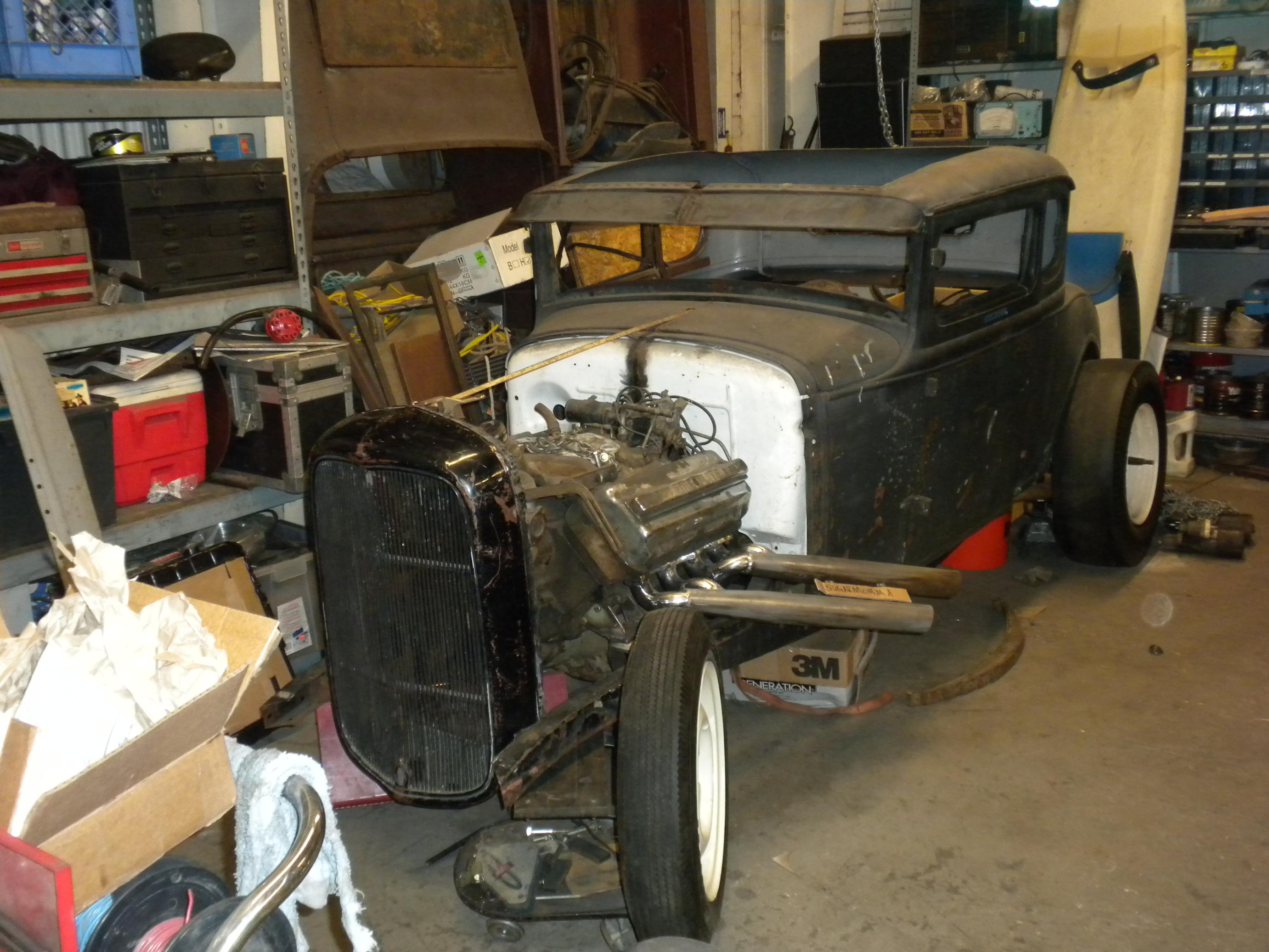

    Here is a photo to inspire you:

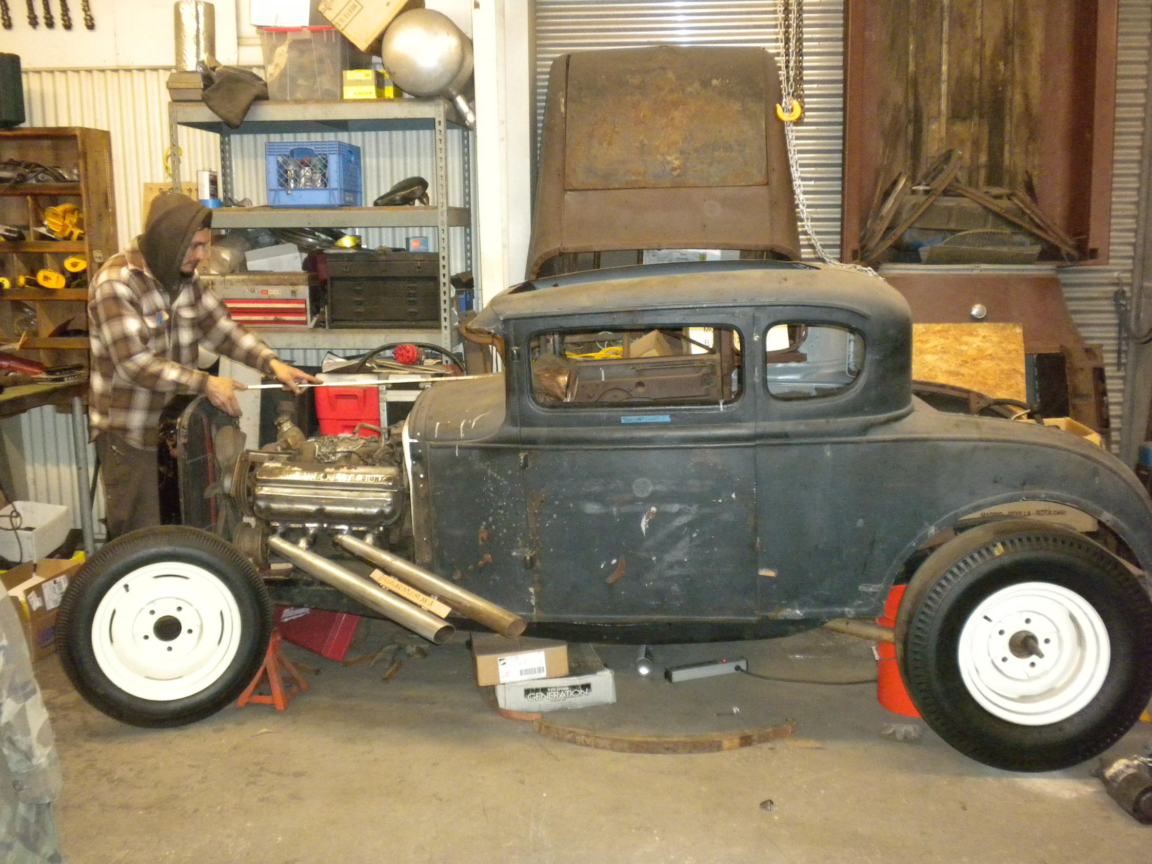

  19. Hot Rod Michelle
    Joined: May 3, 2007
    Posts: 1,620
    Hot Rod Michelle
    Here are some more.

  21. Those side shots make me lean more towards that than the usual Model A or Deuce frame. Holy **** that looks cool.

  26. Hot Rod Michelle
    Joined: May 3, 2007
    Posts: 1,620
    Hot Rod Michelle
    Seen here is the very ilusive Zibo in his natural habitat:
  27. Hot Rod Michelle
    Joined: May 3, 2007
    Posts: 1,620
    Hot Rod Michelle
    Sorry for posting such a big picture, but, at least now one is able to see the frame really well.
    I am pretty sure that Zibo used a model A front cross member in order to pinch it down in the front, but, you will have to ask him directly in order to be 100% sure.
