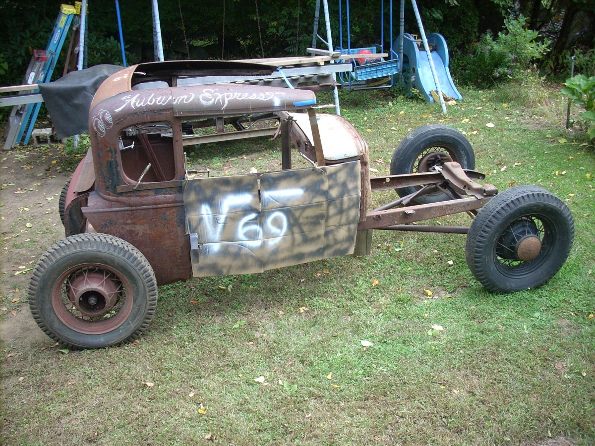

    cut out a c notch. im interested in keeping this ride height, soooo going with a model A frame instead of the '32 i had originally planned. having more headroom than expected this gets me lower and eliminates the confusion in my head about the roll cage. unnamed-10.jpg

    So, you're sitting under the car then? are you going to make a dished floor pan or bellypan the body and suspend some kind of seat on the subframe?

    Your **** is six inches below the cross member :D

    Are you going to have a finned aluminum cover on your rear end? o_O

    yes, but my head is only half way up the rear window. squash er down!

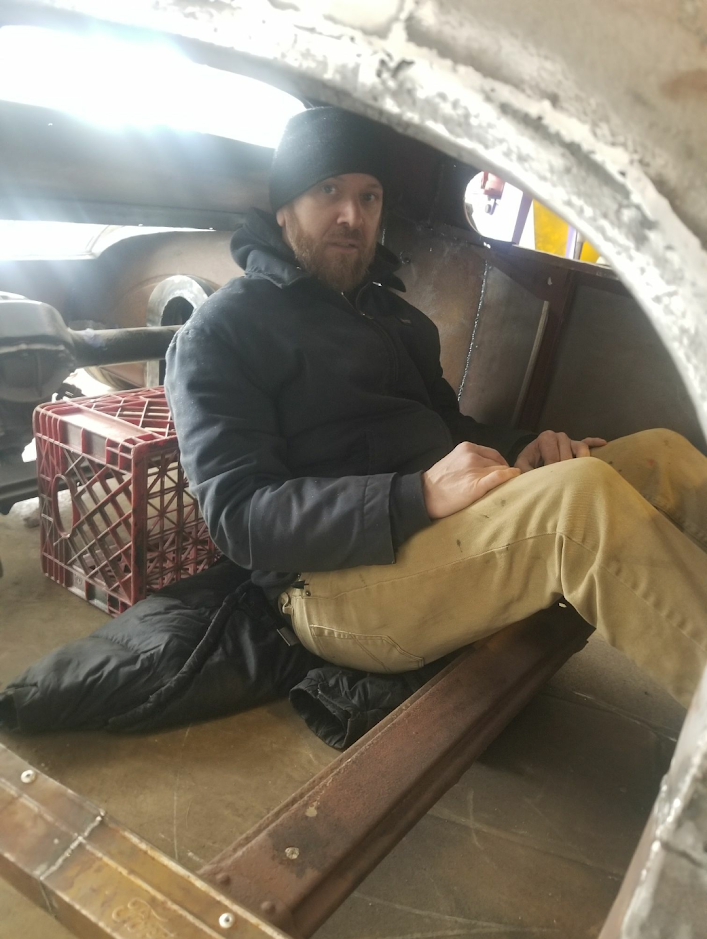

    From that picture above, you sitting in the car it looks like the driveshaft will go through a lumbar vertebrae.

    Just a curiosity question about your interior ergonomics photo. Where were your feet in relation to the firewall and transmission tunnel? I ask this as I am building 2 model T roadsters and it is easy to sit in them until you put pesky things like steering wheel/column and pedals in the way.

    In the photo my toes were on the fire wall. Itll be tight in the pedal area. In my favor, the nose will be longer, so im hoping to get the bellhousing (cast chev) a bit forward.

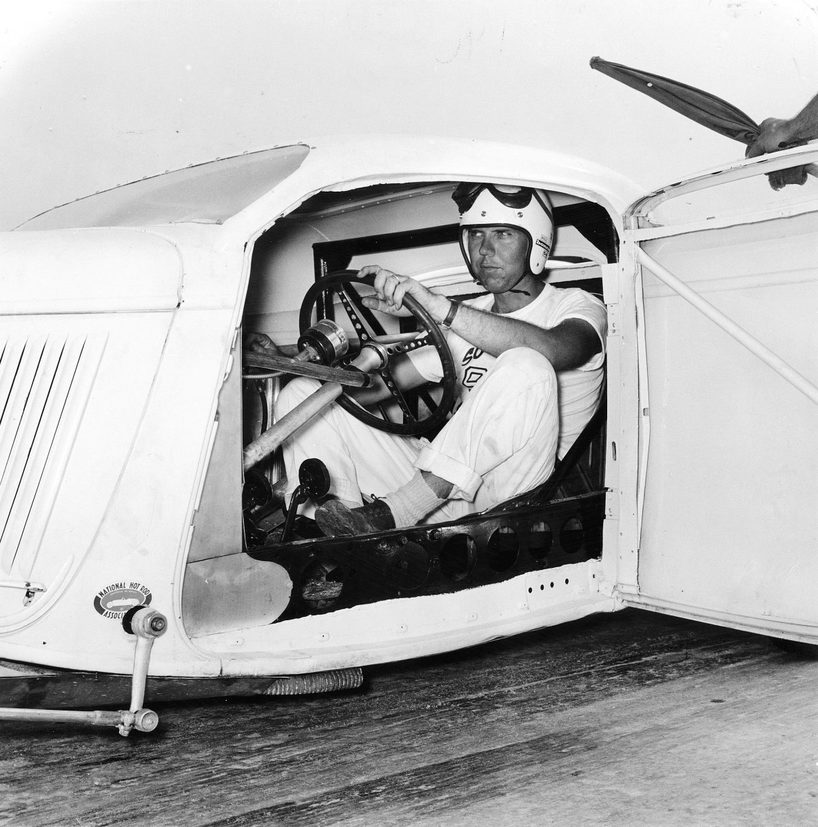

    But this car ^^^ wouldn't be legal to race anywhere now, his helmet is above the rollbar.
    It is tough to tell from this angle, but it looks like it will be tough to squeeze his helmet under a rollcage once a seat is installed (***uming the seat is @ crossmember height). Check with the sanctioning body(ies) where you want to race to see what they require before you get too far into it.
