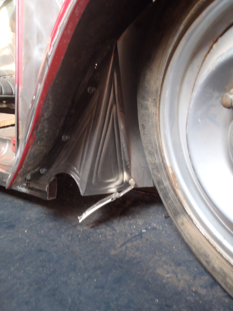

    thank you all , I resumed service on the working tool .
    I show you the beginning of the new wheel arch .
    here the passage of the exhaust .
    and by the creation of the wheel arches.

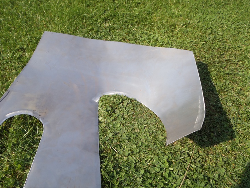

    Metal of course :D
    sheet metal is formed to hammer in the garden :rolleyes:
    compare the right and left to the curve and moldings .

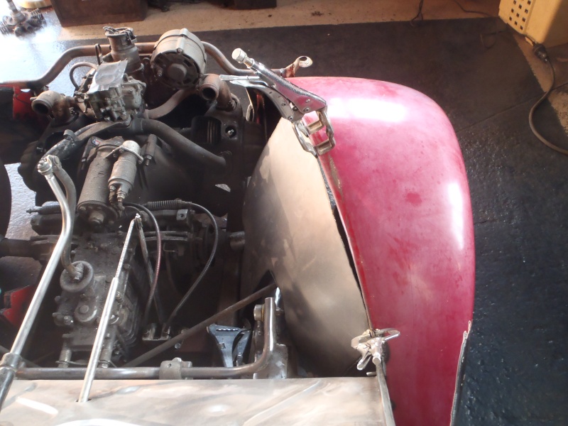

    the back passage and the rest is the front end
    yes I know the engine is really small :rolleyes:
    the friend was very soon .

    folding a sheet metal molding for closures before the cheeks of the front fenders.
    it is good there is still room for small engine : D and the wheels still moving .
  9. Ditch the fan and the shrouds - put vents in the wings. Gets you a couple of horsepower - big deal when you've only got 29BHP to start with... Put a bigger oil cooler on if you do that...
    If you want to put an SU carb on that I can let you have an adapter - but with your skills you can probably sort that out yourself.
