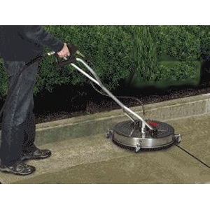

    Here are my thoughts: use chemical or electrical energy to remove - not human energy:
    • Local Commercial Sandblast - all that Rust Proof Compound L will make epic mess, plus operator must not get carried away.
    • Paint Stripper
    • 13hp Pressure Washing - this would be my pick since great for blowing off the loose POR and be totally non-destructive but the mess would be epic.
    • Fluid Film soak at least once a year - it's creeping characteristics are fantastic, 6-8" of creep is common.
    • Or adapt a sidewalk cleaner to shoot upward:
    I'm 70 and will not roll around underneath on a creeper doing anything by hand.

    I think the pressure washer will be your best bet. What is loose will come off, what doesn't will be a real pain to strip. I have used Por 15 on frames and floor pans and sealed inner structures for 30 years. The only problem I had was on some replacement floor pans, should have sanded it for added bite. It pealed right off the new metal, but a 36 grit roloc disc in a die grinder would gum up and wear out and not hardly put a dent in what did stick. Wish you luck. Larry
