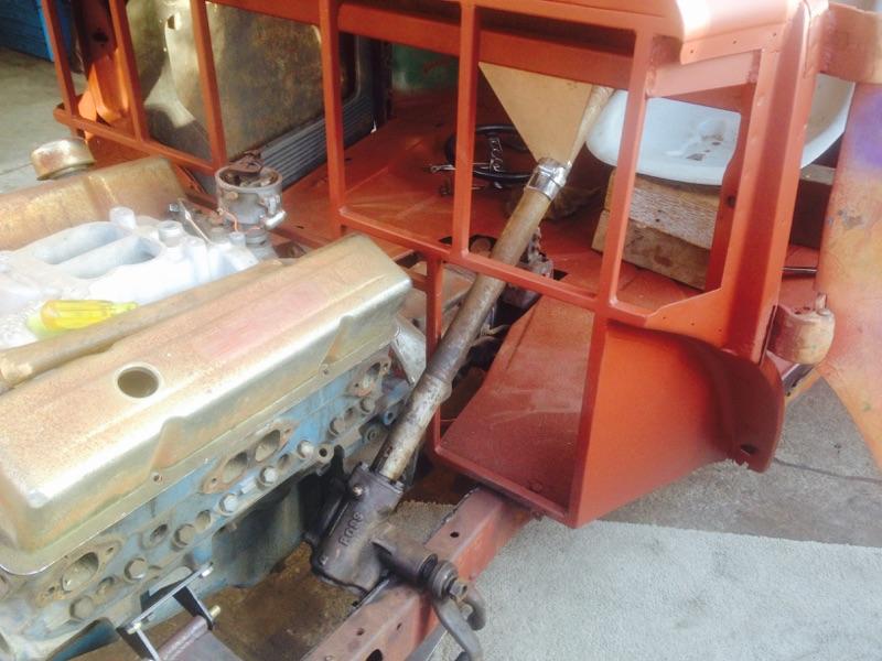

  10. Couldn't skin the firewall until the steering box was in place so I made 3/16" boxing plates for the front section of the frame, pretty thick for boxing plates but the driver side was also what the steering box was going to bolt to. I welded 3 7/16" nuts to the inside and tacked it in place.
    Bolted the steering box in place and made a top mount from the cross bar under the dash.
    Then it was time to make some aluminum panels for the firewall. I used grade 5052, .050 thick.

  13. [​IMG]
    There is flex in that front end when it is open so I will add a couple of diagonal tubes like this and that will really beef it up.
