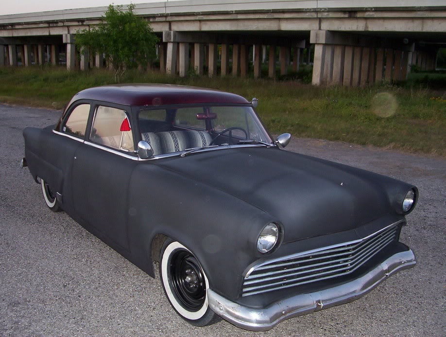

    051107_1.jpg when I was poor 20 years ago.
