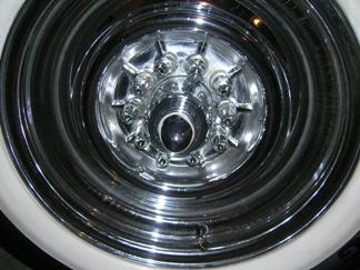

    Here's my truck with new port-a-walls.
    Put about 300 miles so far with no problems. And my old 59 wagon had them too. They were on it for a long time.
    Bullet Man on the HAMB sells them on his site:
    dandsrodandcustom.com
