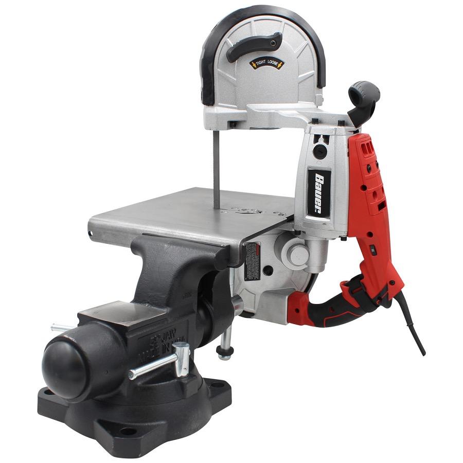

    Has anyone here purchased a portable bandsaw and table such as the one made by SWAG shown in picture. I have a 14" wood bandsaw I use for aluminum and thin steel sheet metal but have been relying on angle grinder and cut off wheels or hack saw for thicker steel. Steel bandsaws are quite expensive and take up quite a bit of room although I'd certainly like to own one. Anyone have a portable and table if so what brand names.

    Yes I have had one for a couple years, and I use it more than just about anything else in the shop. It makes a very handy tool

    I have the SWAG stand that has four legs. It does not require the vice to hold it. Well built, works great. Doesn’t take up a lot of space.

    I have an early SWAG off road bench top stand with Milwaukee bandsaw. I was going to add the later model miter push bar but have to twist object to get perfectly straight cut after neighbor borrowed saw. I suspect he crowded it and warped blade. I'll change the blade out one of these days. I zip tied the trigger and added a HF pedal on-off switch so I can feed with two hands.

    I have the SWAG table with harbor freight portaband. By far my go to method for cutting up to 1/4" thick straight cuts as long as I can work with the 5" throat depth. What I love is the mess is very confined when you're done ... whisk off the table and bench below and that's it. Compare that to cutting disks, plasma cutters etc ( which I have , but use much less since I purchased the bandsaw)

    One of those Swag stands and porta band saw would sure be something that got used a lot though. I see all kinds of possibilities there.

    I have one of the early SWAG units you put in the vice with a Millwaukie portaband , and I use one of those spring loaded clamps to hold the trigger down. It works awesome and is one of the handiest tools in the shop for doing clean cuts on brackets, etc. easy clean up, not real noisy, no dust, no smoke, just a great tool from a great company. I would love to have a big metal cutting band saw in the shop, but the reality is my little SWAG unit works fantastic. My best friend went to collage with the owner/engineer of SWAG, and I have known him since I was in my early 20's. great guy to do business with. He always has a booth at the Portland Swap Meet (inside at the EXPO), and usually has some swap meet specials.

    I have the swag stand, mounted a Milwaukee saw and am quite happy with the combination. I sprung for the foot control switch which I like a lot. It is great for making exhaust pipe cuts.
