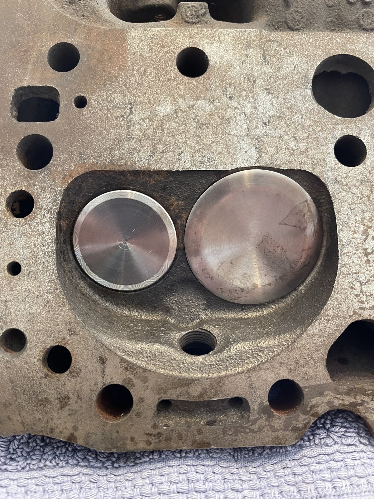

  3. Tossed a couple valves in
    Deuces, Tow Truck Tom and jimmy six like this.

  5. I have some ported power pack heads.
    My machinist gave em to me
    Putting em in my 283.
  6. Any pics of these Anthony?
    Deuces and anthony myrick like this.

  8. I can get some probably tomorrow
    Probably more polished than ported

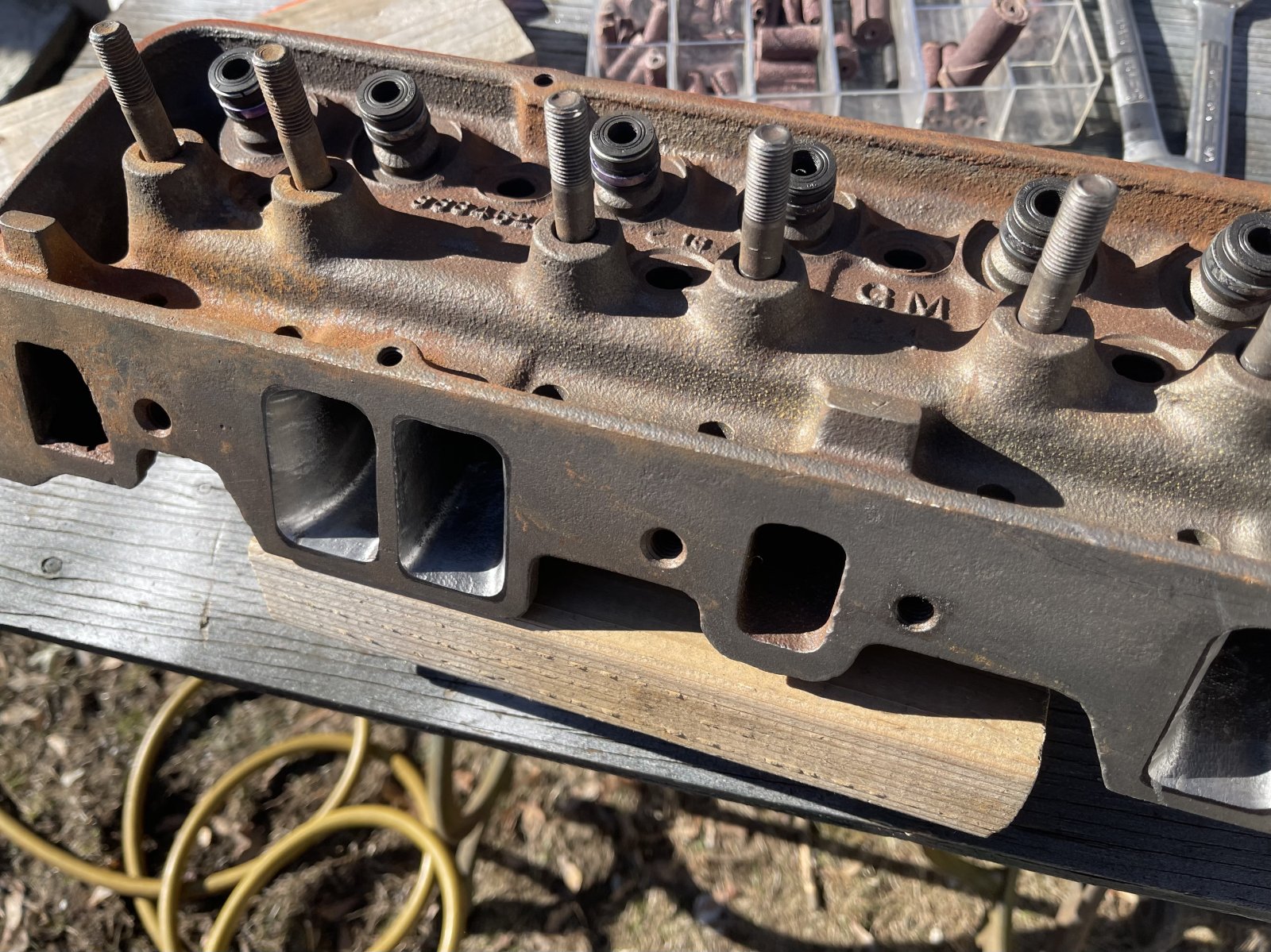

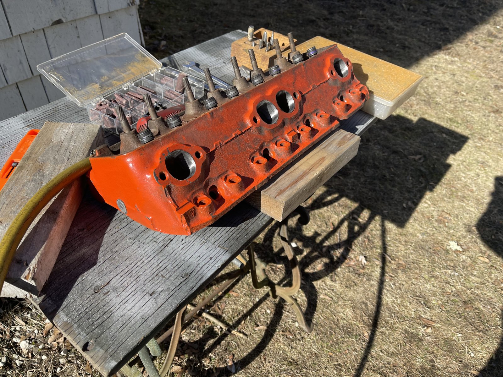

  19. Getting there

  20. Deuces
    Joined: Nov 3, 2009
    Posts: 26,424
    Deuces
    loudbang and BOSTONCAMARO like this.
  21. Not sure why my pics always upload like that

    I like your porting location, I try and do all mine outside as well, better light and ventilation, bonus is the easy clean up.
