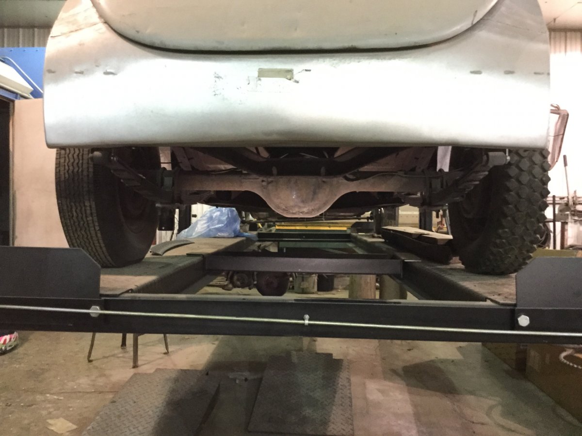

    I put the kit on my 1940 ford coupe and noticed that when you look at the car from the rear, the front of the springs angle towards the center of the car. Nobody really talks about that. Am I being too picky or what. I don’t like it.

    That’s how it supposed to be. most parallel rear leafs are pointed to the center of the car at the front spring eye. Some more than others. Most are very slight. Look at the rear springs on a first gen Camaro or Firebird. They are noticeable.

    Not being parallel actually makes the rear end more stable. When the leaf springs are truly parallel, then tend to want to lay over and shift the axle side to side a bit on turns rather then flatten out and act like springs. You can probably make them more parallel then they were designed to be, if you really want to, but I suspect you wouldn't be happy with the vehicle's handling.
    The parallel spring designation is a design as opposed to a transverse spring designation. It gives you an immediate vision of the spring layout. Even front parallel leaf springs are seldom actually parallel. Gene

    A pair of deep arch [high load] leaf springs will want to roll over with lateral forces applied.
    If you had one spring straight ahead and one at 90 degs to that, one would stabilize the other laterally [but mechanically impossible due to spring arc movement] .
    If you pointed both springs inward 45 degs it would be the same scenario ^^^ [but mechanically possible]
    But they only need pointing inwards enough for the arc of the axle [during bodyroll] to pre-load the opposite side.
    Having springs in a "V" pattern removes the need for a panhard bar

    1957 Ford promotional materials highlighted the non-parallel rear spring positioning and the benefits thereof.
    I doubt it was a totally new concept then, but it’s the first time I ever saw it in brochures and ads mentioned as a benefit.
    Some of that taper occurs naturally as most ch***is are wider at the rear and narrower at the front to accommodate the front wheel arc in turns. Some ch***is, especially trucks, are parallel rails about two thirds or more of their length, then taper toward the front.
    By the way, even if the springs were equidistant in the mounts, when viewed from either end, they would appear to be closer at one end. It is a natural effect, which IIRC, is called parallax distortion. You can notice a similar distortion also when you view a dial face, a clock for example, at an angle, not head on.

    D6E696D2-05E8-4051-90B9-7E1262EF3100.jpeg D6E696D2-05E8-4051-90B9-7E1262EF3100.jpeg 9CD5596F-A1AA-411B-BDE7-97E276737A78.jpeg 9CD5596F-A1AA-411B-BDE7-97E276737A78.jpeg 9CD5596F-A1AA-411B-BDE7-97E276737A78.jpeg This is just a mock up. Yeah, maybe it’s ok.

    Sometimes ya just need someone to say it’s ok. Thanks for all the input. I will keep building

    I always thought parallel was parallel when I designing The rear suspension in my car. But the springs would not fit so I Angeled them a bit, I was worried about them until I measured a few cars and found out they are all angeled. Triangles are more stable them parallel.
