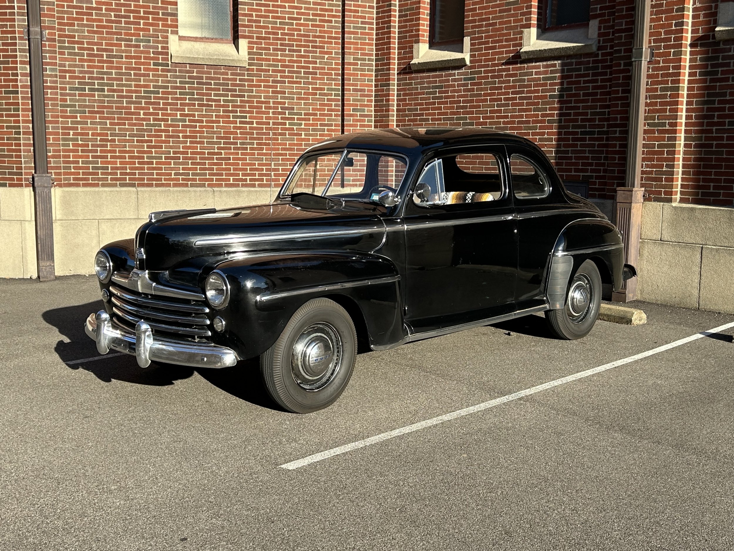

  1. Before I order a Posies In-Da-Dirt front end and rear SuperSlide, reverse eye, transverse spring, to lower my ’47 I thought I would see what everyone’s take is on these. Did you use the spring packs as they came or did you take any leaves out? I think my car sits a little high, even for a stocker, but if get the advertised 5” drop in front, that should barely tuck the sidewall tread of my 6.0x16 Firestones into the fender, a little. SO I was thinking about pulling a spring out of each pack.
    I am also going to order their dropped steering arms and rear spring shackles as well. Also, I can see dropping down the front tires a size or two soon.
    If I get time tonight, I will try and photoshop a picture to the "advertised" amount.
    Any advice is appreciated!

    I can't help you on the super slide, but I can say that is a damn fine looking shiny black old Ford.
    -Abone.

    If you get 5” of drop in the front, a 600 tire will probably rub the fender. A 5.50 or maybe even 500 would be better.
    And, why would you need dropped steering arms if you aren’t dropping the axle too?

  13. Using a 6' ruler, in the rain, the best I could tell this is about 5" lower in front and about 2-1/2" in the rear. It's nothing scientific or anything to base decisions on, but a little fun on a rainy Friday night with a margarita. It does make me want to do a more accurate one!
