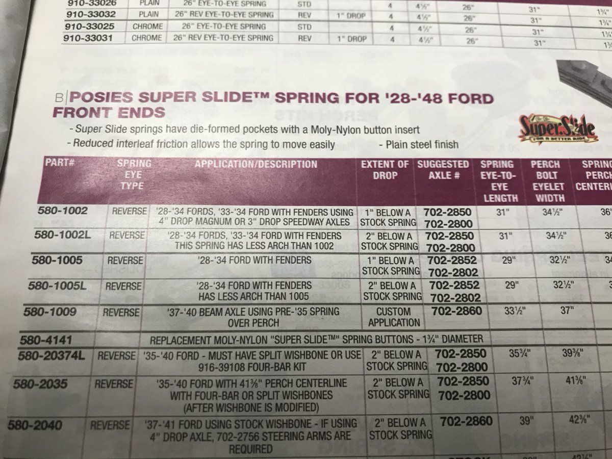

    Based on my experience replacing leaf springs on my Chevy 3100 (2nd Gen) - Speedway resells Posies products. In fact, the fellas at Posies directed me to Speedway since Posies did not have my spring in stock and SW did. Indecently, the improved ride these leafs provide my solid axle pickup exceeded my expectations.
  22. Speedway is now selling Posies springs. You get free shipping at Speedway. I bought my front from Posies because Speedway did not carry the one I needed. The rear spring from Speedway was a Posies with free shipping and I got it on a discount day. Saved almost a hundred bucks. I will say Posies has better service. Have their springs in my roadster and the ride is great. Will see how the coupe is when finished.

  26. Fordors
    Joined: Sep 22, 2016
    Posts: 6,292
    Fordors
    The above photo from their catalog clearly shows Speedway lists Posies Super Slide springs, and online the listings call that out too. I would think Ken Fenical might have something to say about it if Speedway was using his trade name inappropriately.
    Also, could you elaborate on what was inferior about Speedway’s service? Saving almost $100 and getting free shipping sounds pretty good to me.
    ct1932ford and vtx1800 like this.
