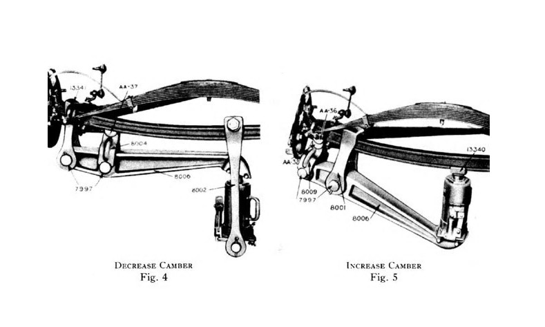

    You may have to get after bending the axle yourself...it certainly is doable with a chain and small hydraulic jack or porta-power piston....as suggested in this post

    All I can say on correcting the camber is that you haven't looked far enough for a shop that can or is willing to do it. It damned well isn't rocket science except you have to know where to tie it down and where to put the pressure to bend it back where it belongs. That might include figuring out where it is tweaked in the in the first place.

  27. Jimmy Six had the correct advice go to a truck axle repair shop they'll straighten it while in the car.
