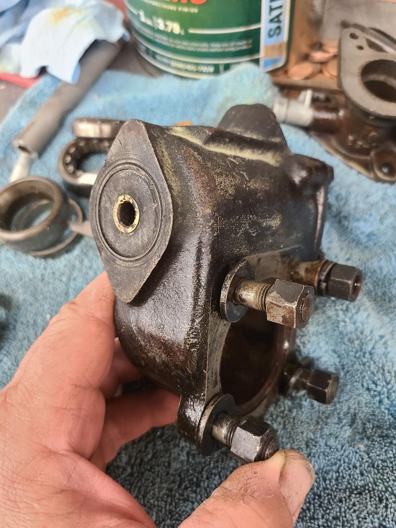

  12. Deere boy
    Joined: Jul 25, 2018
    Posts: 80
    Deere boy
    647ABD51-6274-45BE-9216-E95F54A98C79.jpeg This is identical to what I have except I currently have a quickener on it.

  15. alchemy
    Joined: Sep 27, 2002
    Posts: 22,926
    alchemy
    I bet that Deere box says Gemmer somewhere on it. Sure looks like an old Ford, like an F-1. If you are looking for a modern replacement, flipping around on the Borgeson website should prove fruitful. They make boxes for all kinds of stuff from hot rods to muscle to trucks to industrial. One of them has got to have a similar architecture and a good ratio.

  16. big duece
    Joined: Jul 28, 2008
    Posts: 7,067
    big duece
    from kansas
    That box is the same as 32-34 Ford Gemmer... John Deer used them. The casting on the end is not drilled and tapped for a light switch. thumbnail (12).jpg
    clem and rusty valley like this.

  21. Deere boy
    Posts: 80
    Deere boy
    I already did. It’s just like the green one above. The model A one is 50 percent larger.

  23. alchemy
    Posts: 22,926
    alchemy
    That new Borgeson box looks like a good replacement if the direction is correct. Did you read the specs?
