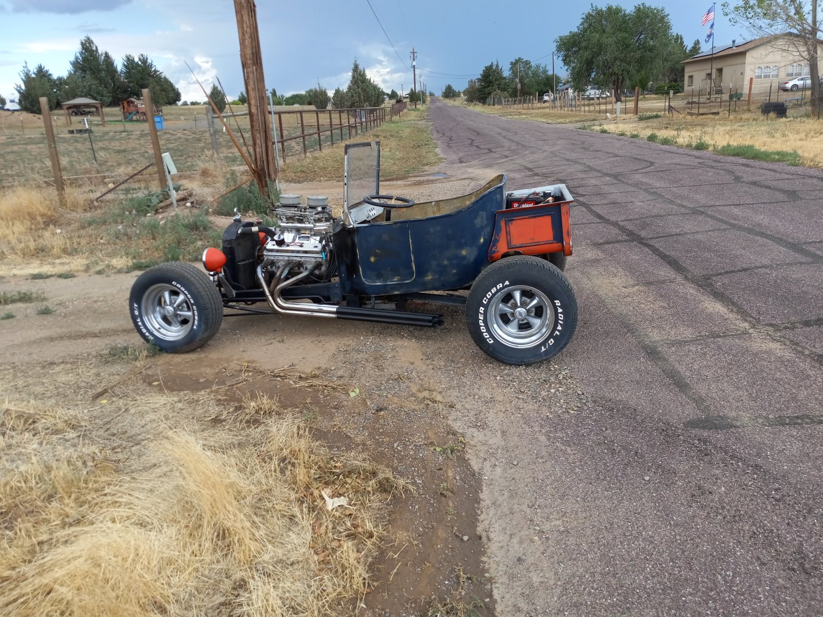

    Swapped in the sector shaft in the steering box. It could still use a rebuild ($350 in parts plus reaming bushings), but it's good for now.
    Also swapped out the diff for one that didn't have the spiders welded. Replaced one axle bearing and both seals.
    Still couldn't find any chevy wheels, so took off the unilug Cragars from my van in the backyard and bolted them up. They are not right with the wide fronts and the white letters, but an improvement.
    The rad shell is off since it only had one bolt and a piece of hose holding it on. Also sanded down the mess on most of the bed. Took the spacers out from between the floor and the ledge in the body. It isn't much different visually, lots still to do but it doesn't try to go into both ditches at the same time. The header shown was also sanded down, primed and painted. The other side is just sanded.

    It steers well, but has a small death wobble at ~35 MPH. Just drove it up and back on the street in the background. As you can see, it's thunderstorm season. Just wanted to make sure the fixes actually fixed things. Lots still to do. It drives now, so I'll bolt back up the plates and lights in the back and go a bit further now.

    the very wide front wheel/tire setup might be part of the death wobble problem...also, if the tires are as old as they look, that can contribute

    Drove it carefully around the block a few times, then a couple miles to the local nursery to weigh it (they sell gravel, rock and dirt). 1000 front, 1120 rear, 2120 total with my 200 included right over the rear. Pretty heavy for a bare body and lexan windshield! :) Hey, all the race cars want 50/50 and all the weight between the axles, this fits! :D
    Didn't overheat, but did vary so the t'stat is going to get checked/replaced. 180-215. Still want to put on a mechanical fan and remove the ugly.
    Death wobble still there, suspect the wheels and tires aren't helping, but will go over the other bits too.
    Also going to take out a leaf in front, it doesn't move with me bouncing on the perch.
    When it was behaving, it was fairly pleasant, sitting on a bedspread. Will work on seating also.

    Trailer tires on the front helped move the wobble to higher speed. Verdict: still have worn parts, but those Cragar fronts are not good. Also had the lug nuts back off on the left rear. Not fun.
    EDIT, the burnt fuse for the fan was replaced, but loose. Pretty sure that's the cause for the temp fluctuation. Jammed it in better and no change, 180 for the whole drive.
    Otherwise, a bit better, so progress. Will buy tie rod ends and drag link ends. I'll have to take the drag link ends off to see which to buy, there are no threads showing. Would make sense to have a L and R, but will check. Drag link has a bend to clear stuff, so you can't adjust length in place anyway. Seems to be a single application for all early ford stuff.
    MOOG ES416L Fits Drag Link End; 3.22" Length or Front Left Outer; 3.22 (in)
    MOOG ES416R Front Right Outer; 3.22 (in) Length
    Can someone ID the shackles? They are not the Speedway style with bushings, I got a pair with the car.
    Seems like they could be Model A since these have the zerks
