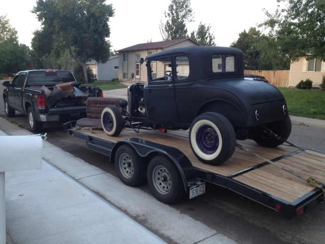

    She is a twenty footer.
    Too good of deal to p*** on, other wise I would not have gotten her.
    She came with a lot of issues........

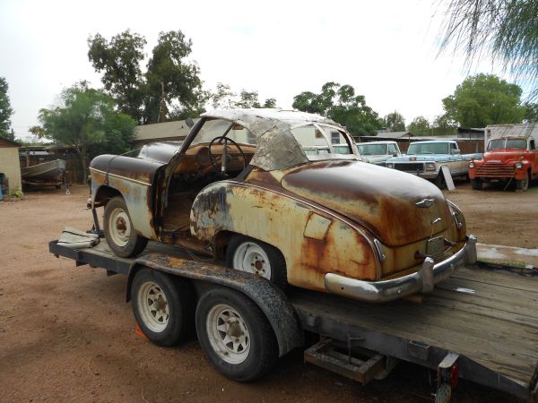

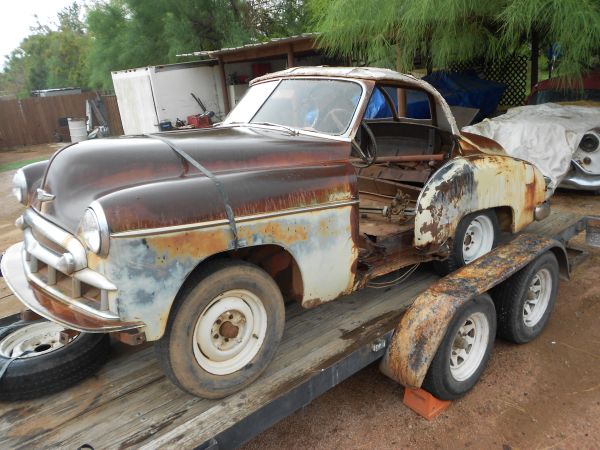

    Found this on Craigslist, reminded me of one of the other posts...
  3. Bad Eye Bill
    Joined: Sep 1, 2010
    Posts: 841
    Bad Eye Bill
    from NB Canada
    Some one got it half right,,, got rid of half of that Chevy! :D:D
    Just kidding, don't shoot! :eek:
  4. I kinda like it! From a "potential" point of view, anyway.

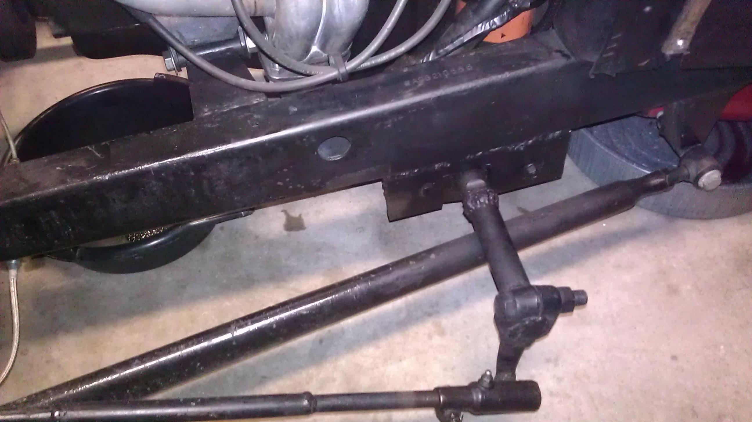

  14. Scumdog
    Joined: Mar 3, 2010
    Posts: 630
    Scumdog
    That is so bad in so many ways - I guess the tapered holes in the spindle have been drilled out for the bolt running through the heim-joint?
    And all the eyes on the 'suspension' look to have been welded on, including the one on the steering arm
    The only safe item is the split-pin on the tie-rod nut.
