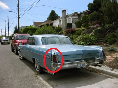

    what you want to do is not going to happen.

    here is the area/part of the car

  9. I cannot be done. Anything you try will either destroy the part or crack in short order

    I would just paint them and bolt them on. That way you will have a nice clean crack. Any other way will cause random cracks.
  12. Any Bondo, plastic filler, Duroglass or other mud will crack eventually and destroy your paint job. Moisture will get in from the back and wreak havoc as well. Either get them rechromed, paint them body color or live with them. It looks like a nice old car, don't booger it up with Mickey Mouse repairs
