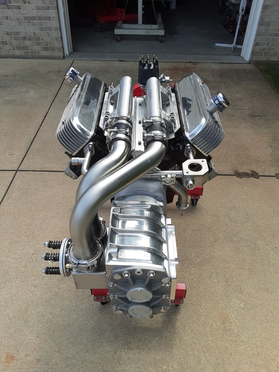

    I have made great progress this summer. The adapter 3D model is done and out for quote. The adapter in the photos is still wood. All the intake and water plumbing it done. F.A.S.T ignition is ordered. I have a "Ma**" brand distributor with an MSD "phasable" rotor on board. I am working on the fuel rails now. We're getting closer but still a ways to go. It has turned into a bit of an obsession but I can think off worse things, :). Current photos attached.

    I just have to do the Stude because it was overlooked when the Potvin's were made. All Stude V8s have a forged crank and rods so they can take the boost. Their heads are not the best for a naturally asperated motor but their McCulloch / Paxton superchargers made them fly. The motor will have about 8 PSI boost with a 471. If you want more boost just go to a bigger X71! The main point of the build is to do something no one else has done, have fun and make it work. It's all on the "Racing Studebakers" site.

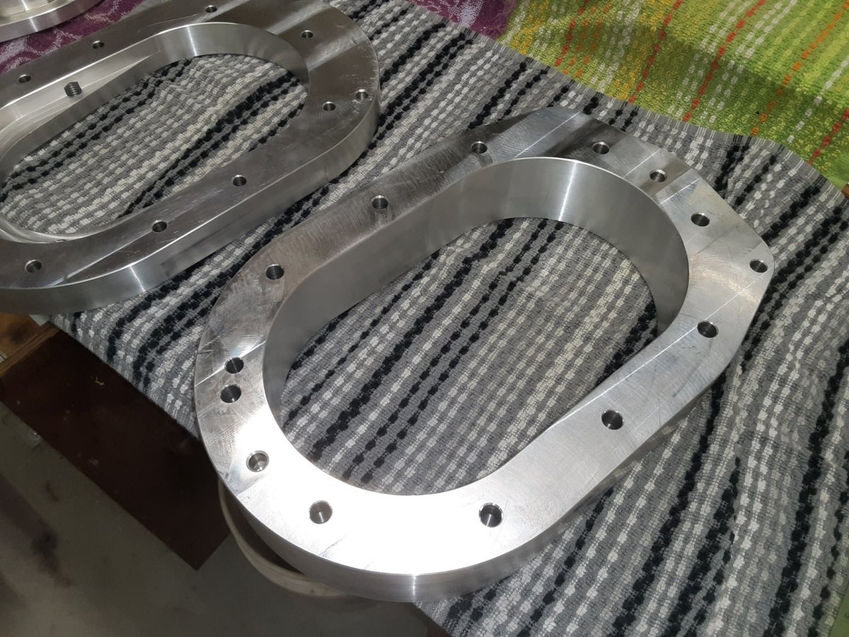

    I have some serious progress pictures to post. The 3D model of the adapter was completed and printed in plastic, it fit perfect. I won't bore you with photos of that because... I sent the 3D files out for quote to machine in T-6061 and the price came back at $1650.00 including material. So it was game on, an order was placed and I picked it up two weeks ago. It also is a perfect fit. The adapter is all dowel pinned together and to the blower. You rely on the coupler to align it with the motor. The next step is to re-key the crank and have that half of the coupler machined for a snug slip-fit. More to follow in a few weeks.

    Did you have a local machine shop make the adapter? Or did you use an online machine shop? Seems like a reasonable price.

    I live in Fort Atkinson Wisconsin. The machine shop is in New Berlin, less than an hour away, W&S machine. The ***embly is three pieces all bolted sequentially to the blower and then it slips onto the motor via a chain coupler. The orange half is a 3D printed plastic for fit-up. The steel piece shown needs to be machine to slip fit on the crank, that will happen next week. On Take Off Blower.jpg Plastid & Metal.jpg

    The individual parts are also o-ringed and have stainless steel thread inserts for strength. I ***ume I will need to dis***emble this at least six or more times before it sees fire so I do not want to deal with a stripped aluminum thread. They are a step up from a Heli-coil. It was not a big cost adder machining wise and the inserts are only a couple of buck a piece so it's cheap insurance.
