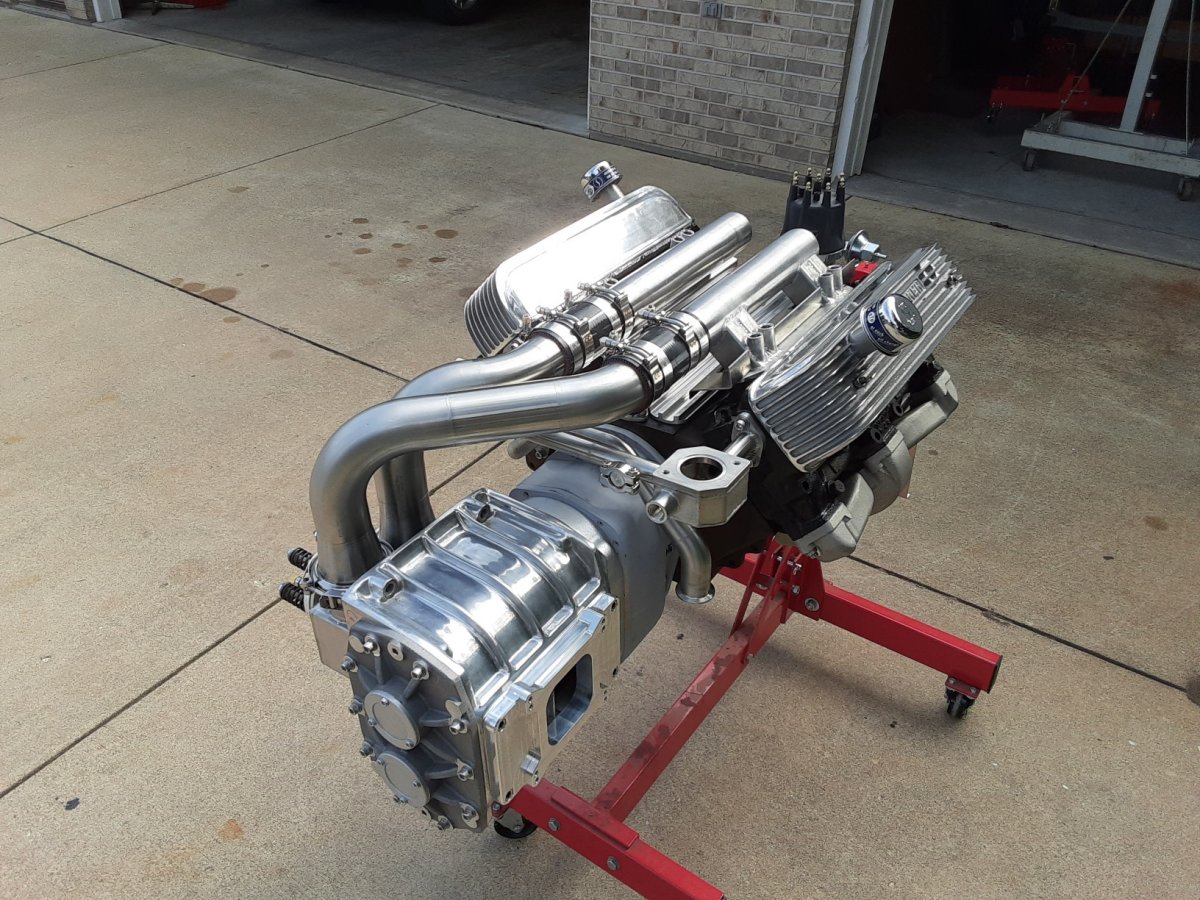

    Wow I'm subscribed!!!! I'm building a 32 with a potvin hemi.That turned out real nice!!!!! That is going to be so cool I love anything with a front blower on it. Can't wait to follow tis build its going to be a good one. 2021-03-04-01-11-40.jpeg

    Hey are you planning on running an alternator if so how are you going to drive it? I'm struggling with this situation I may have to run a pulley off the front of the blower and a fuel pump at the same time but I'm not sure if The fuel pump shaft will be strong enough to power both. Or run fuel pump off the mag and just power alternator of front of blower. Pretty much the only two options?

    This is really cool. I've contemplated building a 299 Stude V8 with a roots blower on top. Do you think I could make 550 HP with a streetable combo?

    I'm going to need constant power to run electric motors for cooling fans and water pumps putting radiator in the back of the car and I'm running a starter and lights. I thought about running a charging system off the rear and that could be an option but if I get stuck in traffic the battery will go dead. I just do not think I will charge enough power to support al of that. Front mounted blowers are great for drag cars but I'm trying to drive mine on the street as well.

    Ok so what type of injector are you going to run and how are you driving the fuel pump? I love how you did the water neck that looks real nice. Everything looks nice. making that gear 3d print was a great idea so cool man.

    That looks killer!!! Where did those slick exhaust manifolds come from? they would be great on the 259 Stude in my 31 Sedan.
