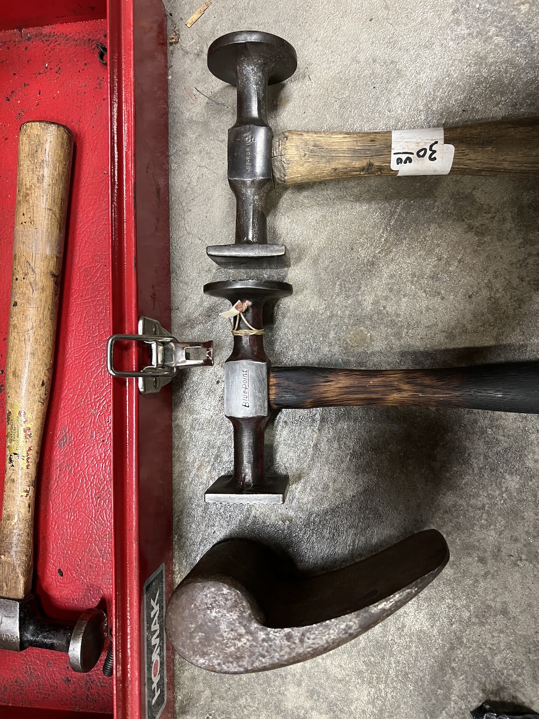

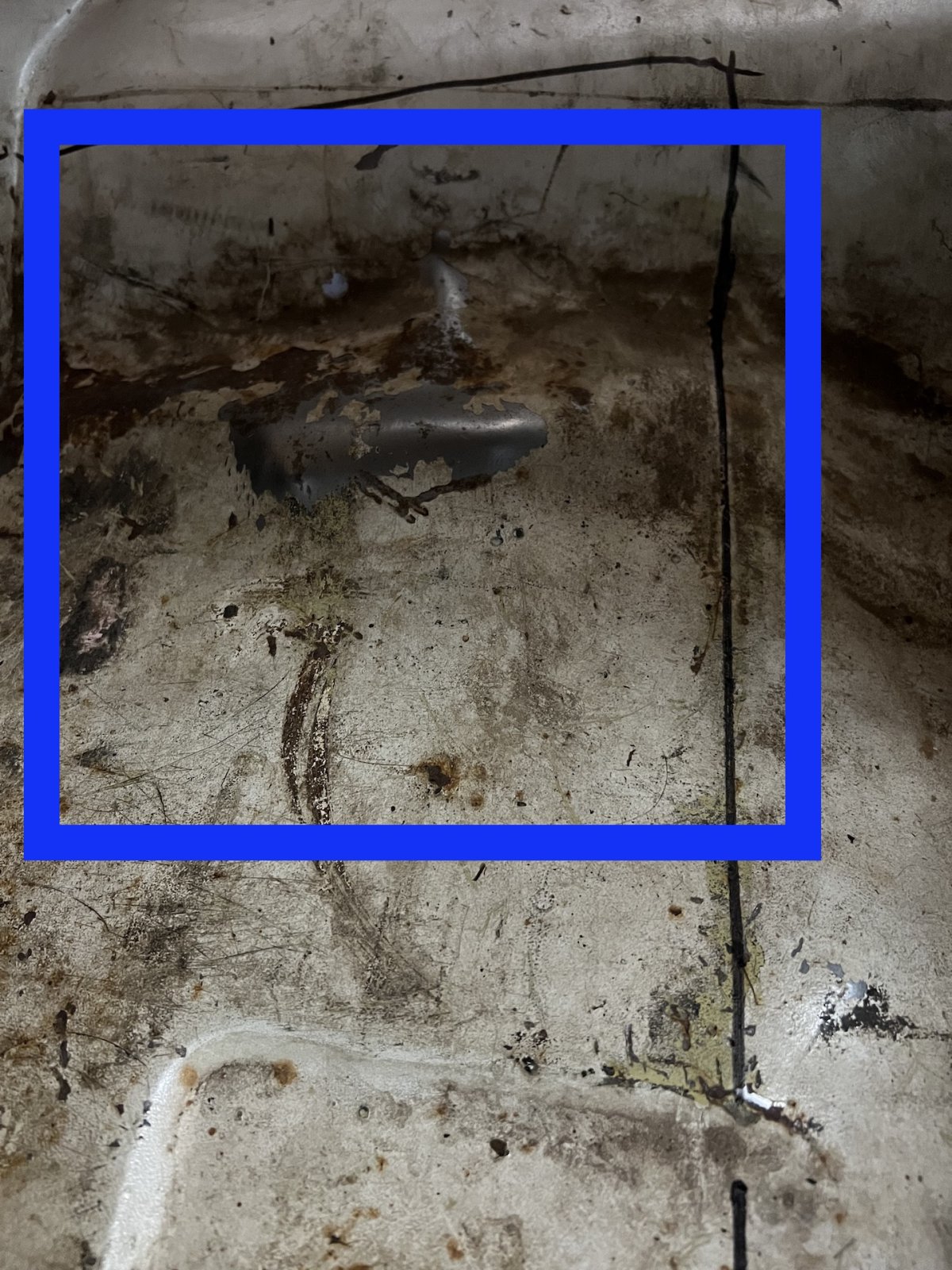

  10. Sorry for the late pics but here they are. The one of the hammers are what I have at this point for hammer/dolly work which I assume I would use to 'finish' smoothing out the metal. The floor pics is of the area that needs to be flattened, how the %#@$%%$# the PO did this I am not asking. But there is inner rocker just forward of this area so that helps. I am thinking of using a 2x4, like was suggested, and putting my scissor jack underneath for a flat piece to hammer against. Sound good? This area is all solid and any metal that gets cut out is well forward.

    2x4 on end, smack with hammer, shape as best as you can. This will relieve any pressure on the surrounding metal before you cut it out.
    The better the metal shape is the less problems you'll have when you cut out the panel....

    all dents are kind of the same. hit only where the metal is stretched. I would get a floor jack and a piece of steel, or wood if you don't have any under the dent with light pressure, then I'd smack the high spots.

    I'm no expert, but what I've learned is that dents are best handled like swedish employment law - last in, first out.
    If you hit the deepest center of the dent (i.e. where the metal started to deform = first in) you don't really reduce the size of the dent, you rather make a new dent going the other direction inside the original dent. Tempting to attack the big deformation first, but might not be the best way - could be causing more problems later.
    As I learned, you usually start with the edges of the dent (the metal last pulled in towards the deepest center), where the metal has barely deformed, you go around the dent and slowly tap the metal back to original level moving in a spiral towards the center until the dent is all gone.

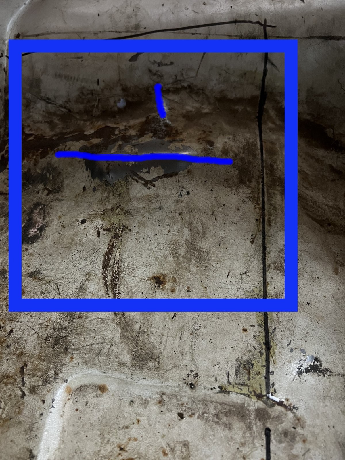

  20. Pist-n-broke: the outline is of the replacement pan I have. I called a club member who used to make car bodies over and he suggested to cut only what is bad. So I won't be cutting anywhere near the dent. Also, when I upload photos on my computer it gives them to me in MB sizes and I don't to oversize them and make them huge on the screen. I will try to make them larger for people to see though.

    the dent in the photo was all formed in one big bang. probably ran over something.
    I'd start with the small one.
