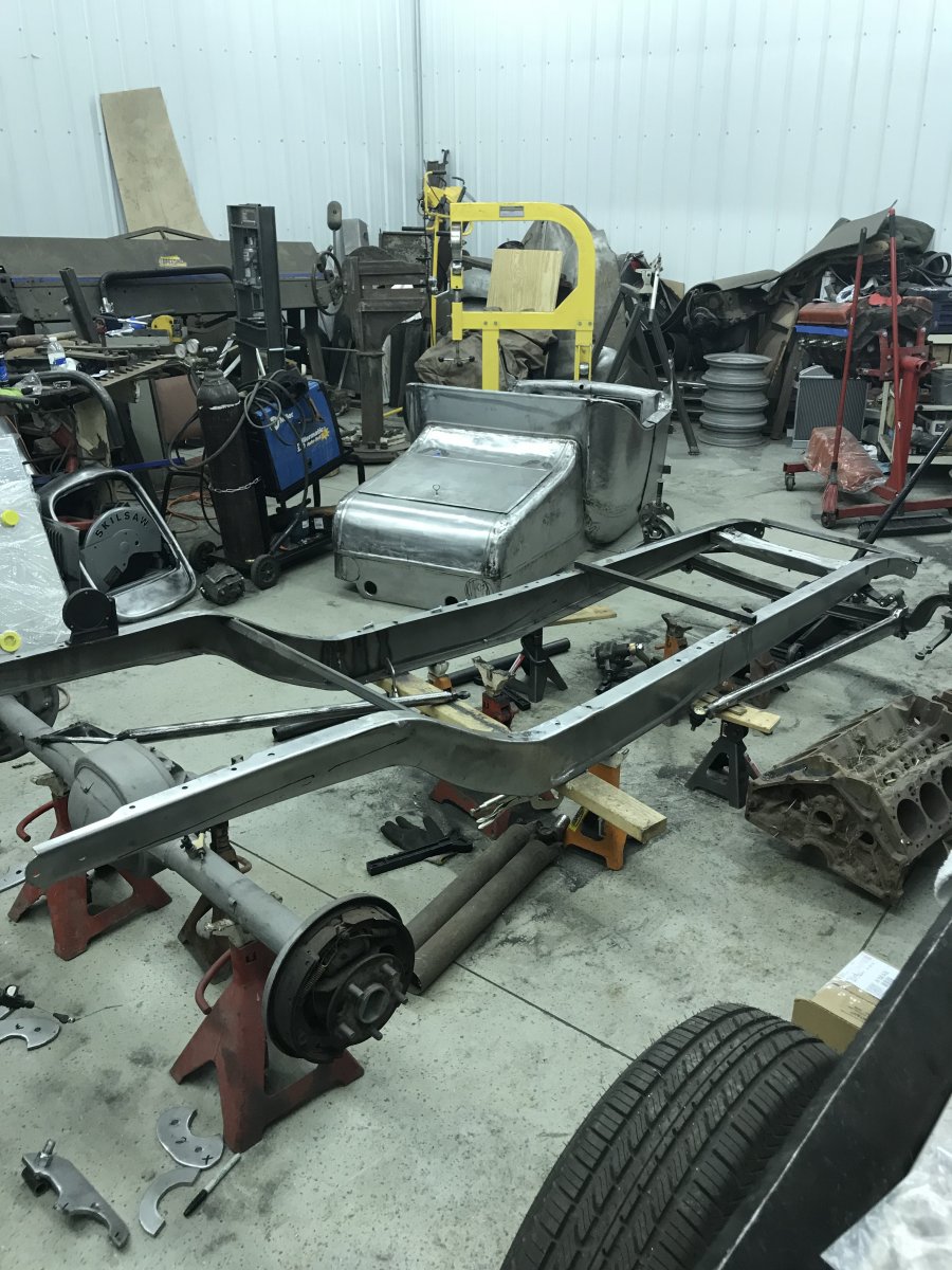

    Great build thread. I am surprised how more "substantial" the car looks with the height of the 32 frame below the T body. Did you take all of the curve out of the 32 rails when you built the ch***is?
  16. justabeater37
    Joined: Jan 1, 2009
    Posts: 1,824
    justabeater37
    Shortened the rails 9" and kicked them up with a wedge cut of about an inch between the body mount bolts in the curve. It left the rear of the frame rails level to mount the turtle deck.
  17. Flipper
    Joined: May 10, 2003
    Posts: 3,457
    Flipper
    from Kentucky
    So they still have the 32 curve outwards in the middle? In the pics of the frame without the body, they kinda looked like the curve wasn't there anymore.
    BigRRR likes this.
  18. justabeater37
    Joined: Jan 1, 2009
    Posts: 1,824
    justabeater37
    Curve is still there. I just laid the frame rails out and cut the crossmembers to fit the width of the body.
