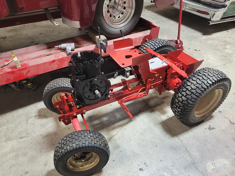

    Rebuilt this 1969 Wheel Horse over the winter of 2022/23.
    Powder coated every piece I could. Frame, axle, sheet-metal, brackets, etc. $750 at MC Custom Coatings in Springfield. Worth every penny, and this thing will cut gr*** and blow snow for another 50+ years.
