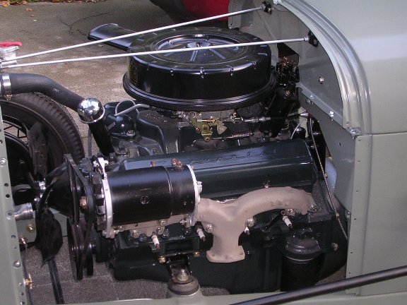

    I do my own shit...a lot cheaper and faster than paint. I sandblast it and then chuck in the oven for a pre-heat to rid of oils, etc etc and then let cool for 5 min...then shoot....45 min later after curing and cooling, I am set. $18 for 2lbs of powder is sweet - www.pendrypowdercoatings.com
    Here is some of my work:

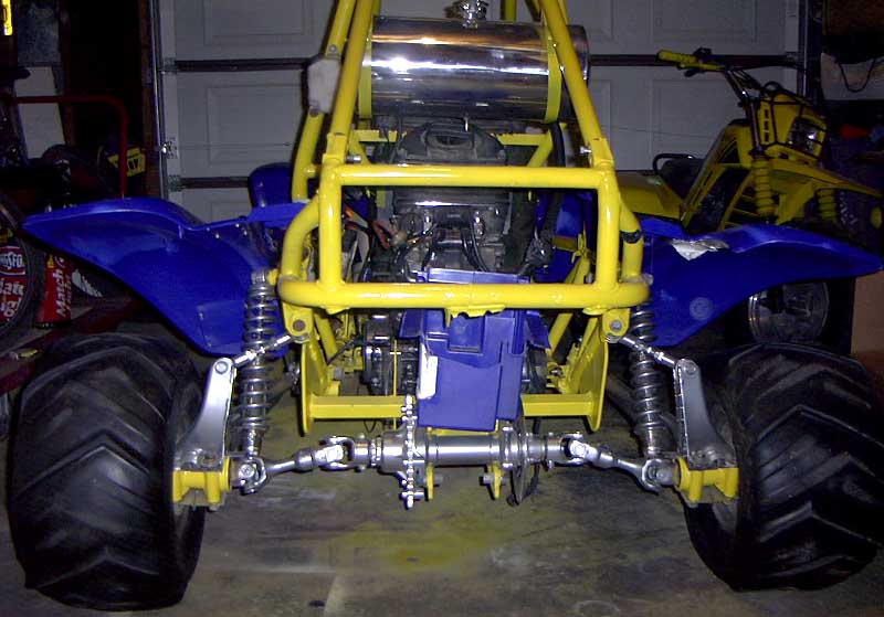

  23. Aeroman
    Joined: Apr 19, 2005
    Posts: 707
    Aeroman
    and some more...

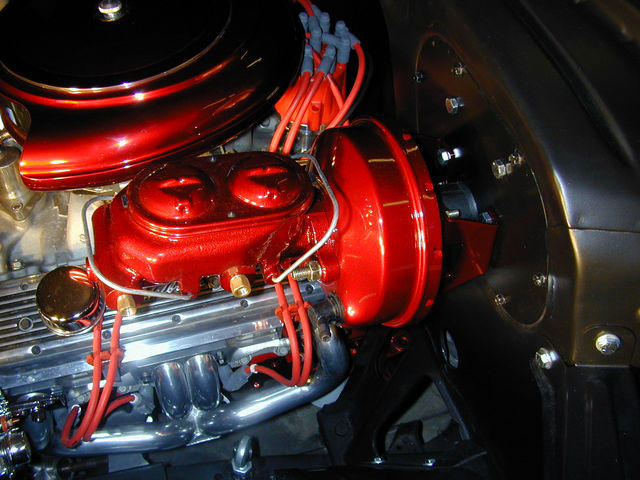

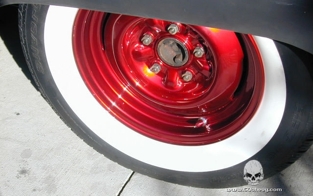

    Ouch I paid out my A$$ for a powder coating pocess called color chrome.
    Silver base, then a candy, then clear powder coating.
    $100 a rim vs. $50.00 for a non-custom color.
    I normally went with standard colors. But I was looking for something that would match HOk candy apple red.
    Recently I found a new powdercoater that does custom colors.
    They have a process called "color chrome"
    They tried to match House of Colors cAndies.
    Looks pretty nice.
    I attached a pic of a rim powdercoated this way.
    The 2nd attached pic is a bitchin products cast caddy air cleaner powdercoated with color chrome.
    (The nice thing about the powdercoating was it flled in all the imperfections in the casting. If it was painted would have taken alot of prep time)
    Next to the air cleaner is a mast/booster painted with House of Color gold base w candy apple red.
