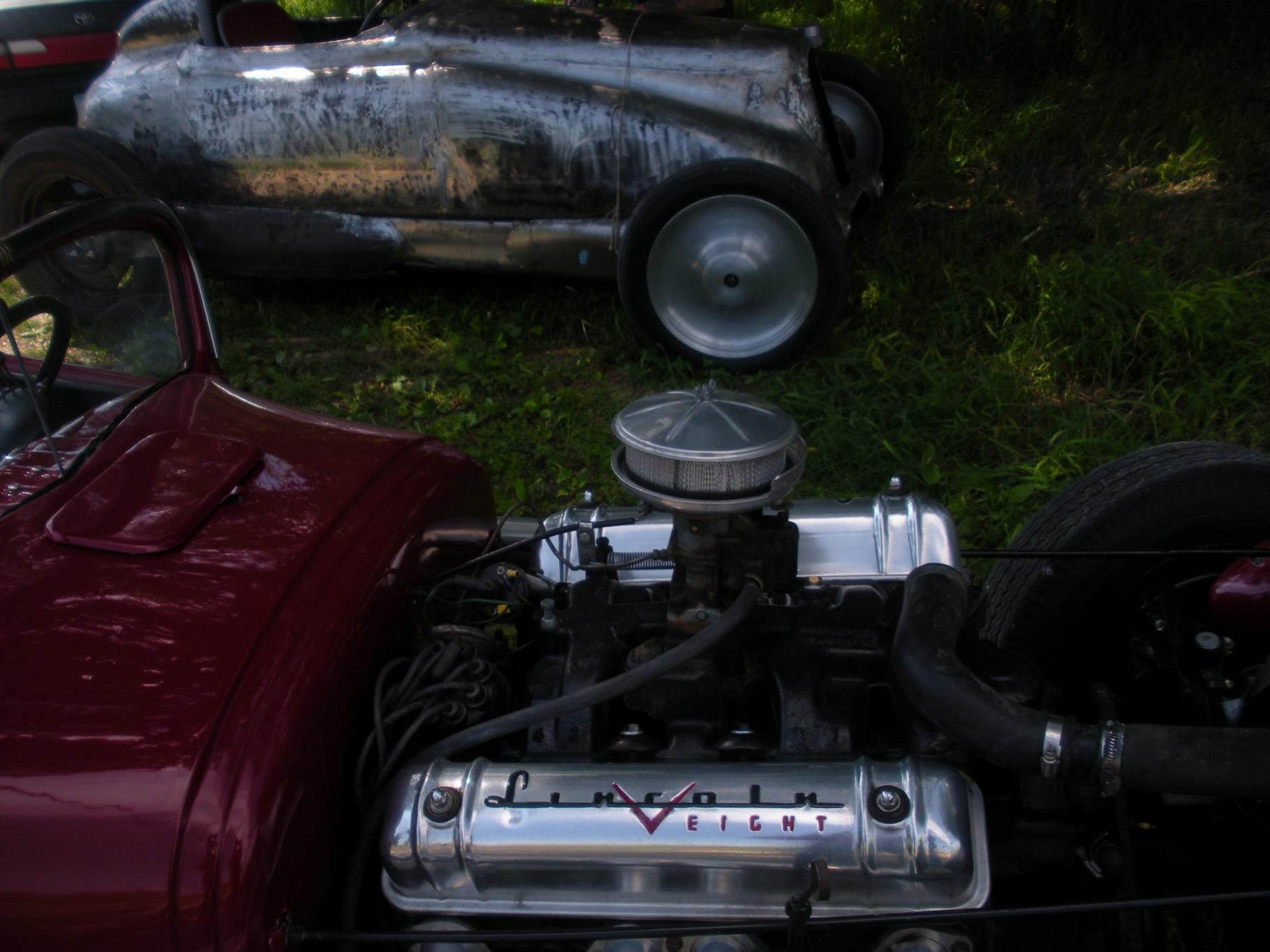

  14. All these replies are on the money. It dos not replace chrome! But if you want a nice aluminum look, it is the bomb, just like the examples say. I really think it is awesome when understood and used for a clean easy clean and quite durable finish. Here is some things we have done. We are featuring
    Rob Lee's valve covers and air cleaner, not the bare metal Hoodlum in the background. ~sololoo~
