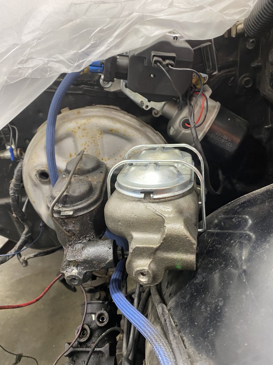

  17. Most “kits” use a corvette type MC.
    They are kinda big.
    here’s a typical “kit” aftermarket MC next to a 1968 Pontiac drum/drum master cylinder
    C1FD8D83-C892-4164-9E96-C938F4783ADC.jpeg D50ABECF-875E-4012-AA49-CA04FF862557.jpeg
    I’ve built several braking systems for hot rods using the geo metro booster with great results. Some have the metro master cylinder as well.
    You need to understand what’s important and how to make some brackets to make it work. But it fits a lot of small places.
    582F40ED-C140-41F8-B62D-3F880D99FC06.jpeg 36E67501-E12B-4867-ABF4-909EC3D62D28.jpeg
    There’s also a system similar to the Old T birds. There’s a small tiny single bail MC attached to the brake pedal. The line goes to a remote booster and works a dual bail master of your choosing. It has some obvious drawbacks but also some obvious pluses to complicated confined builds.
