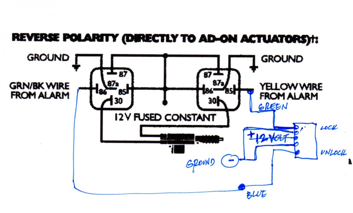

    Decided to install some power locks to my 32 coupe (stock door handles).
    Got the mounting and linkage all figured out and installed to the Bear Claw latches but I'm stuck on the wiring.
    I am using a generic remote car alarm module with relays to the locks and I have the wiring diagram for the alarm wires to the locks but I need to have a switch inside the car to lock/unlock without using the remote.
    Here is the wiring diagram .....where can I wire a switch to operate lock unlock thru the relays?
  2. Install any additional switches in parallel with the inputs from the alarm box. Using a momentary-contact SPDT switch, connect the ground to the switch 'common', then the other sides to the same place as the alarm box inputs; 86 on one relay, 85 on the other. This assumes the control box is furnishing a 'ground' to operate the locks, which is what the diagram shows.

    The switch in the car has 12 volt power to it and could run the lock without relays. Is this the correct wiring diagram?
    The relay has constant 12 volt power to it. I assume you mean to connect the green and blue only to the relay as shown,
