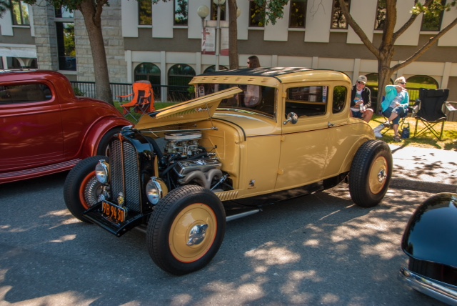

    Well, he did say he hopes there is another show in three years! Pic of John's Model A coupe at Deuce Days 2016.:) John's Model A Coupe.jpg

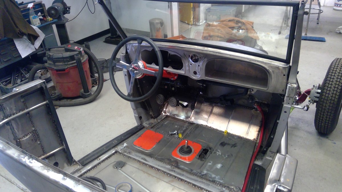

    I am terrible about keeping up with progress, thought it was time to update somewhat. In keeping with trying to source as much as I can from the H.A.M.B., I bought a 34 Buick dashboard from Radicalratrod. It was very much as represented and almost bolts into a 29 Ford cowl. I couldn't be happier with the look. Earlier I as having a hard time where to put the 1895 Quarter and had fairly well decided it would go in the gear shift knob until the dash arrived. It had a clock delete plate with domed gl*** in the glovebox door. I engine-turned a couple of new panels for the dash and glovebox inserts and mounted the quarter behind the domed gl***, so it has found it's home.

    that Buick dash is the "nuts" man. Never seen one before but will be looking now!

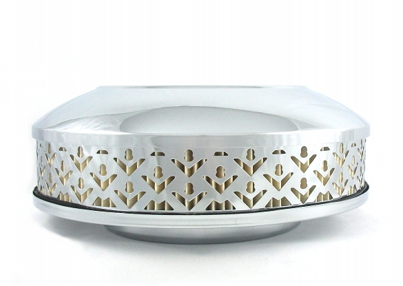

    I'm pretty sure that as cool as they might appear to be with those little Y block V8 cut-outs that they are going to prove to be very poor performers once you get the engine running.
    I doubt very much that they will flow enough air for the engine to breathe properly .

    I agree that they are probably going to be to restrictive, and will probably replace the filter element with a standard one that is a little taller. The real problem I will have is that I have the "D" shaped aid cleaners for my 2x4 y-block, and I will have to modify/manufacture a filter to fit the "D" shape housings. I think that Kahuna, over on the ford barn told me that is what he has done.

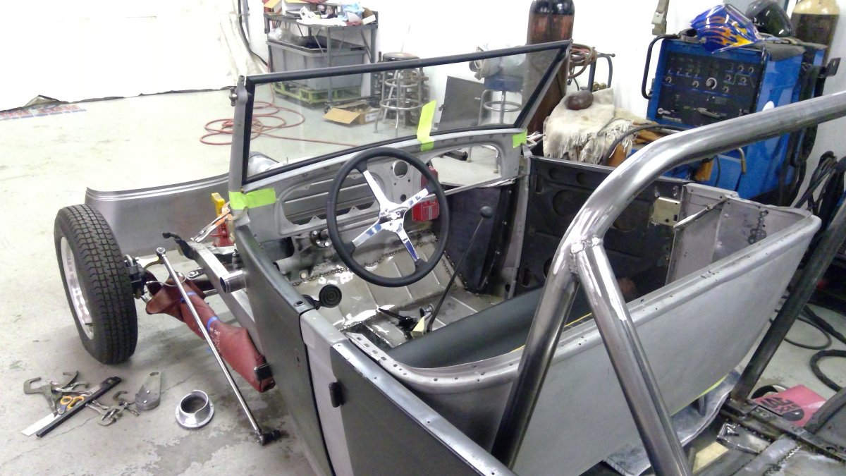

    Huge weekend, really tired but here is just a few pictures of the progress. More to follow.
  17. USMercUte
    Joined: Nov 11, 2008
    Posts: 186
    USMercUte
    Better at building hot rods than at the f***ing computer. Here is the other picture I wanted to post. WIN_20180204_17_47_53_Pro.jpg

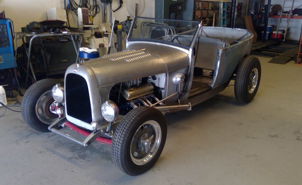

    Hi again guys. Sorry about the lack of posts but after a potentially life ending health experience I am now again back on the project. I'm keeping with my attempt to use as many of the H.A.M.B. suppliers as possible on this project, the latest are:
    • Side steer conversion from Throwback Hot Rod Designs. VERY nice parts. (Sorry Pete Eastwood, I couldn't help myself). VERY HAPPY
    • Drive Shaft headers from Gear Drive Speed & Custom. Beautiful fit and workmanship. And Prompt! VERY HAPPY
    • Br***works radiator custom built to my '28 Whippet shell. A work of art! VERY HAPPY
    I will try to keep up on the progress in the future.
    WIN_20180530_16_39_37_Pro (2).jpg WIN_20180530_16_54_10_Pro.jpg WIN_20180530_16_54_28_Pro.jpg WIN_20180530_16_55_16_Pro (2).jpg

    Nice sheet metal! Any detail on the lower cowl fit and side sub rails to the curved top of the Squeek Deuce frame?
    Lovely project. Dreamy Y-block power, with a wind machine to boot!
    *I have one of those 4 spoke wheels, the two seams should be set at 10:00 and 2:00. That way, you know where the front wheels are in a deft slide...(old Midget/Sprint car trick) Also, your spokes will be in an 'Z' straight ahead...your gauges will be visible...
    kidcampbell71 and loudbang like this.
  20. USMercUte
    Posts: 186
    USMercUte
    Mike in A****er, The deal is on the lower cowl fit is that it is basically channeled 5/8 of an inch from the face of the firewall, tapering back roughly 12". I was able to utilize all 4 forward bolt holes in the Kiwi Konnection frame. Cowl area is very solid. Like the steering wheel idea and didn't realize it was an early circle track trick. Thanks for the nice comments, John

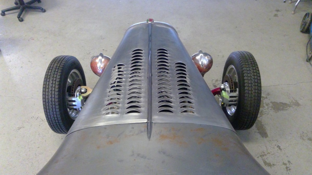

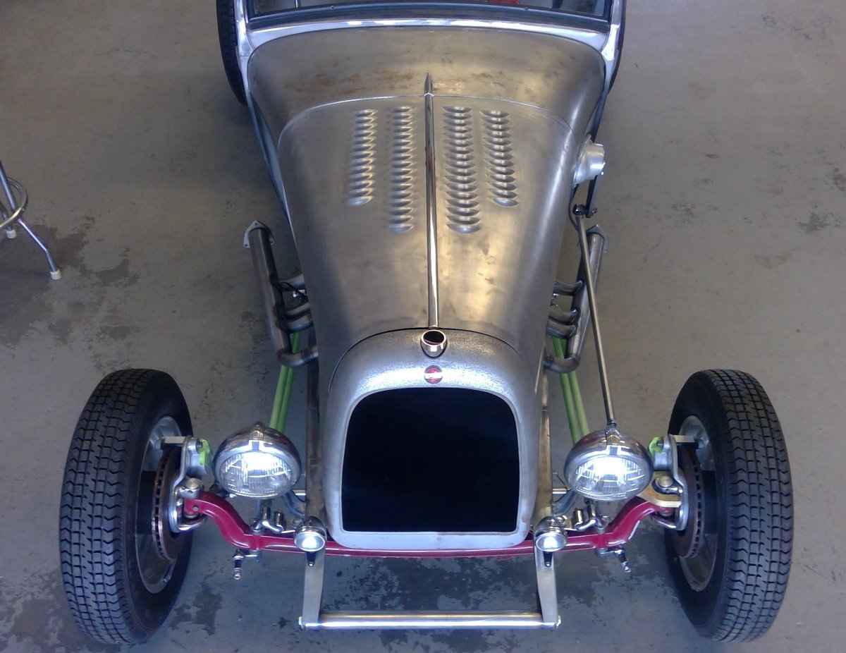

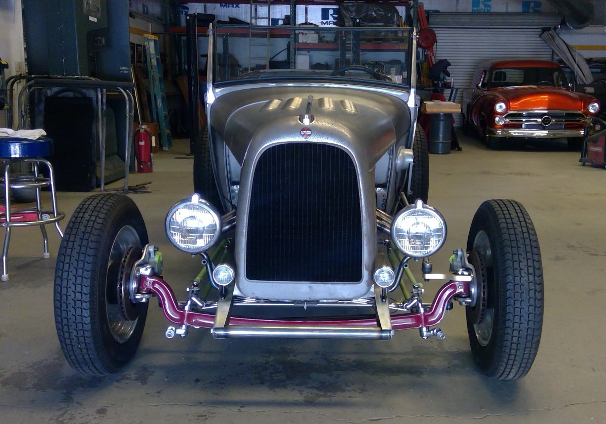

    Wow Guys, time p***es quickly as I get older, but some updates. Because I don't get as much done in a day as I used to I farmed the hood out to Rootlieb, Inc. out of Turlock, CA. Very happy with the results. I added a couple of panels just rear of the radiator to help blend the grill shell in. A few louvers with my curved die to get the air out.
    My last two cars have had Auto Lamp C-430headlights. These are the same headlight used on the Niekamp roadster that won the 1st A.M.B.R. I have to admit I have become obsessed about finding another set for this project. I have searched everywhere I could think to look. After a long weekend away from the H.A.M.B., I sat down to have a look at the parts for sale and there on page 4 I see a pair advertised. Figuring I was too late and they would be gone by then, I none the less replied and YES, they were still available. Jersey Suede on the H.A.M.B., who is actually Lance Sorchik, the hot rod artist, agreed to sell them to me. (check out his artwork at www.lancesorchik.com) I received them yesterday on time, well packaged and most importantly as represented. Now all the pieces of the puzzle are in hand so I best get off my **** and finish this thing.
    Once again, the power of the H.A.M.B. amazes me and I keep making new friends along the way as well. How good is that? John headlights1.jpg headlights3.jpg loovers1.jpg loovers2.jpg

    flatheadpete
    from Burton, MI
    It's so nice to not only watch a killer car come together but to read of the positive ppl (from here and from companies) you've dealt with. Great car. Now get it done!

  26. 54vicky
    Joined: Dec 13, 2011
    Posts: 1,599
    54vicky
    love that full frontal shot in post 53 rather partial to the background on right side:) also
