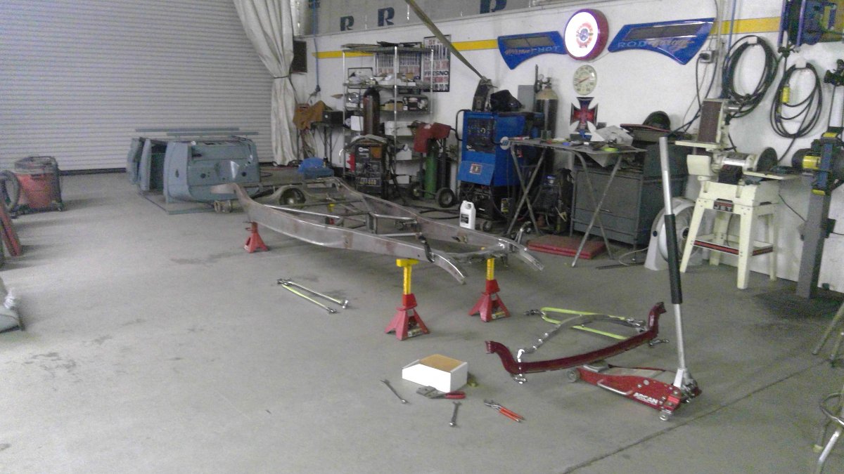

    One step forward and two steps back. Throughout the project I was going to have this a completely open car, no top. Then I received my latest Rodder's Journal and in the article on the 32 Phaeton by Brookville they included 2 drawings of the car with a top on it, done by Chip Foose. While that was it, I got so excited when I saw them that I put the body back on the frame, mocked the car back up and began a tube frame lift-off top. It is 3/4 tubing and will be skinned in .040 aluminum sheet (available in 10' sheets from most race car supply houses fairly reasonable). This should keep the wife a little bit happier. These shots are in the paper mockup stage over the tube frame. Good thing Northwest Deuce Days are not until next July! WIN_20181005_17_25_35_Pro.jpg WIN_20181005_17_25_48_Pro.jpg WIN_20181005_17_27_00_Pro.jpg WIN_20181005_17_27_10_Pro.jpg

    The top is now complete and ready for upholstery. Water-jetted the rear window frames from 3/16 aluminum then finished off with lots of hours of hand work. Now I can blow it apart for the final time to go to paint. Progress. IMG_6382.JPG IMG_6383.JPG IMG_6388.JPG

    Some may not think this is progress, but now the body portion is off to my life long buddy, Lonnie's Auto Body in Medford, Oregon, 3 1/5 hours north of me but I know the quality of the job I will get in the end. Ch***is will be off to the local powder coater (45 minutes away) nice part about living in the country. Next time you see all this stuff it will be orange. WIN_20181025_18_27_34_Pro.jpg
