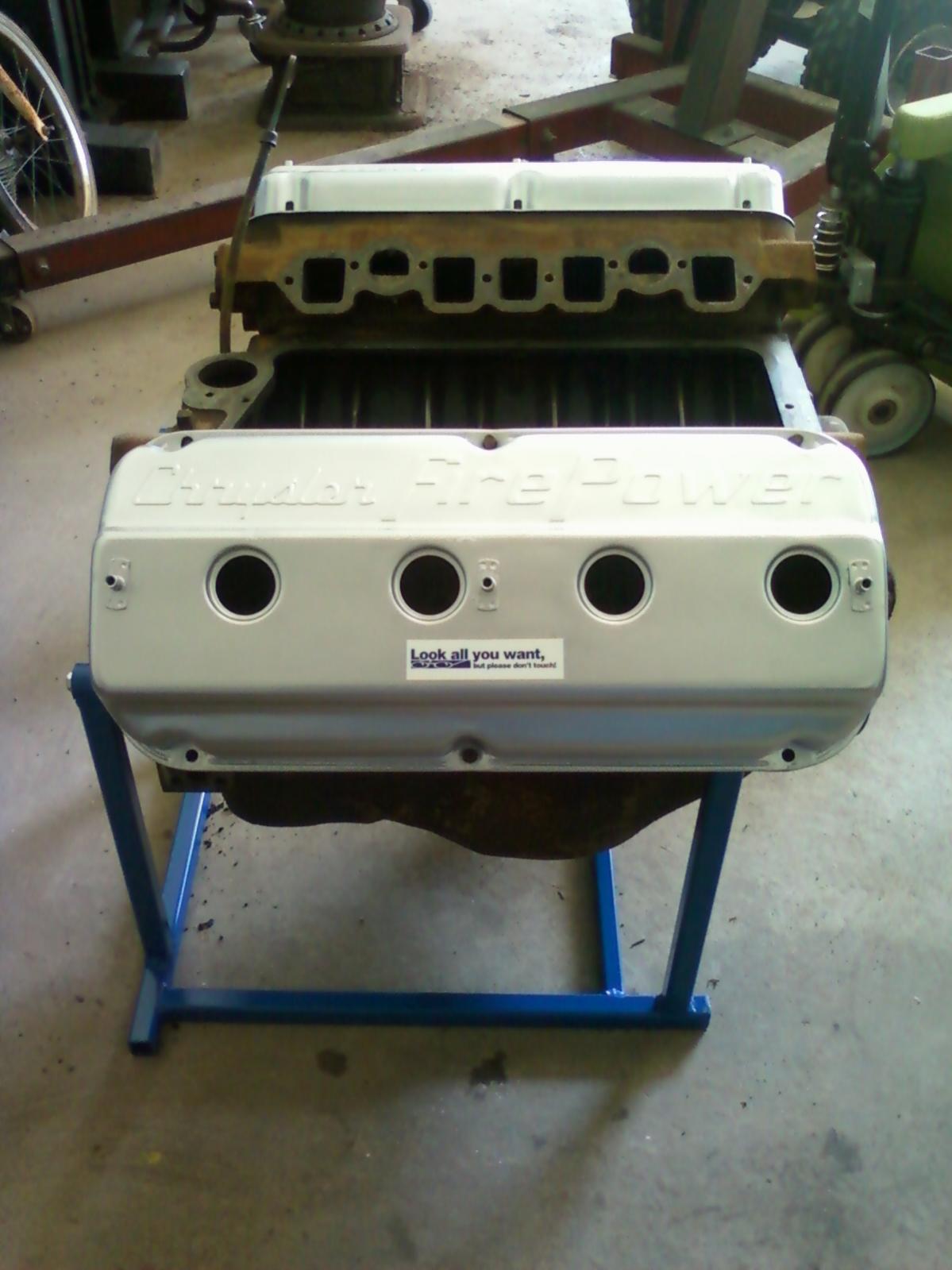

    Yeah, I'm a Chevy guy, but this 392 is my retirement build and sitting in my shop and draws a crowd every time.
