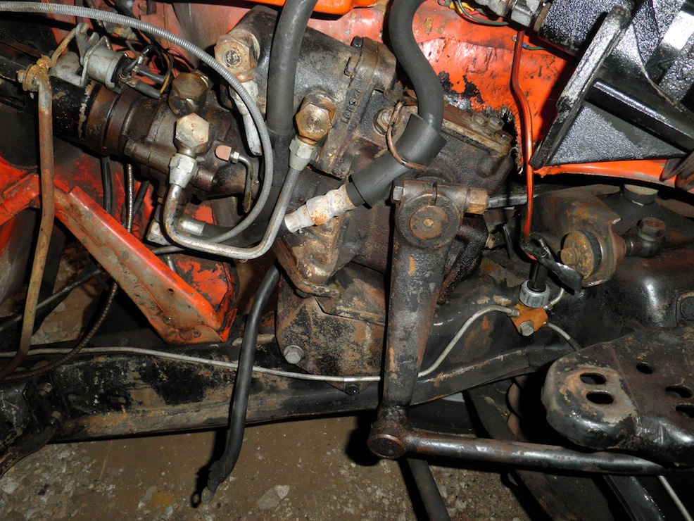

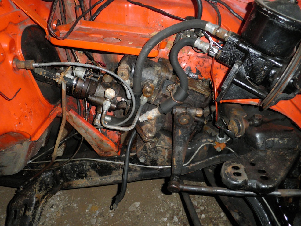

  20. Ray sent me these.; Stude PS unit 004.JPG Stude PS unit 001.JPG 54 chevy power steering.jpg

    Just a point of clarification........the pics in post #20 are from top to bottom....'56 Studebaker/'56 Studebaker/'54 Chevy. You will note the steering boxes appear to be the same basic design, maybe Ross units, but the upper housing is 'clocked' differently one to the other.

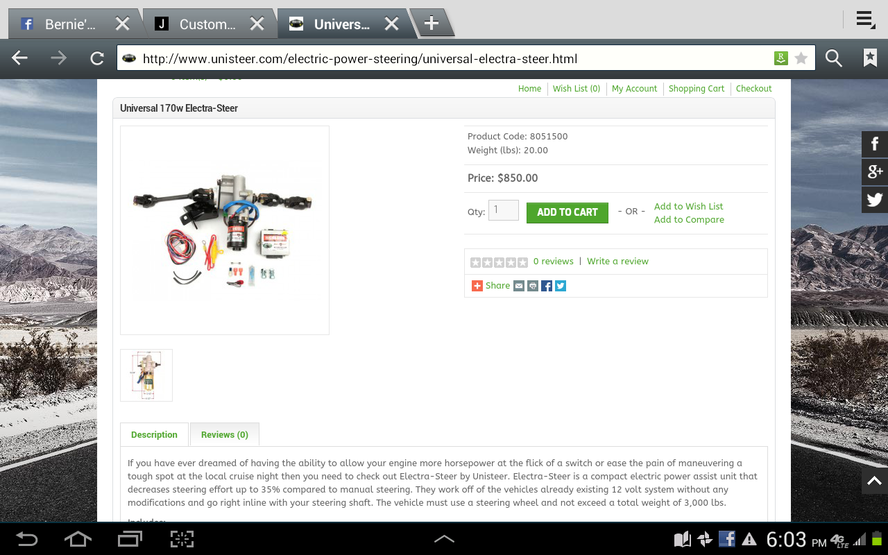

  23. Heres another one unisteer offers without the column.
  24. thanks, still trying to decide on which way to go.
