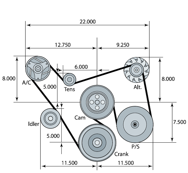

    Only the water pumps were reverse rotation.
    Backside of the belt routes over the WP pulley backwards in an 'S' shape.
    Note the belt wrapping of the A/C, Alt, and PS. They will rotate normally.
    WP, tensioner and idler pulley are run off the smooth backside of the belt and will rotate backwards to the crank.
    Cam ring inside the pump does have an arrow on it, not sure if flipping that would turn the typical PS pump into a 'reverse' rotation pump.
    If the PS pump was sitting on the shelf, assembled dry:eek:, or assembled incorrectly it would not function properly.
    Also when priming the system it's very easy to over do it.
    I normally just fill the Spam can with fluid, rotate it by hand a few times to note if there is any resistance change. If so I know fluid is getting to the vanes. Start the engine and let it idle.
    Lift the front wheels off the ground. Observe the fluid if it is not aerating and no leaks. Then simple turn the steering wheel 90° to the left and let it sit. Look for bubbles. Then turn the steering wheel 90° to the right and let it sit. Look for bubbles. And let the system bleed. If no bubbles, verify fluid is still full, top off if needed, and then rotate to full lock Left, look for bubbles, let it settle and then turn to the right, look for bubbles, let it settle.
    What you DON'T want to do is start up the engine and then immediately crank it to hard LEFT/RIGHT and hear the pump whine. That is causing the pump to max pressure. It doesn't do anything to help bleed and can cause aeration, which will take longer to bleed the system.
    TrailerTrashToo, Ralphies54 and RMR&C like this.
