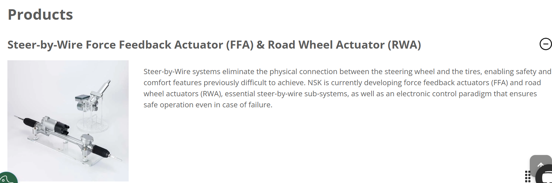

    Here is one I heard of the other day, electric, fly by wire, rack and pinion. No steering shaft interference, put the steering wheel wherever you like and have a clean firewall. I don't want to know the price. On a full fendered car, most would never know it was there.
  11. ottersea
    Joined: Jul 17, 2013
    Posts: 112
    ottersea
    Do not think I would like that. I like to have the road feel.
  12. SS327
    Joined: Sep 11, 2017
    Posts: 4,200
    SS327
    No thank you. I like to steer my cars if the alternator takes a ****.

    My daily 4x4 PU is drive by wire. I actually had a dream (nightmare) the other night I was on a familiar road here in town that runs alongside a creek with a lot of fast moving water. As I was entering a corner in the PU the steering stopped working and I was left careening toward a very watery landing. I awoke, took a piss and returned to bed.
