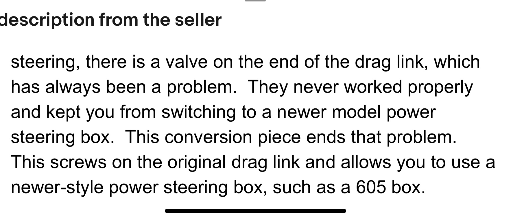

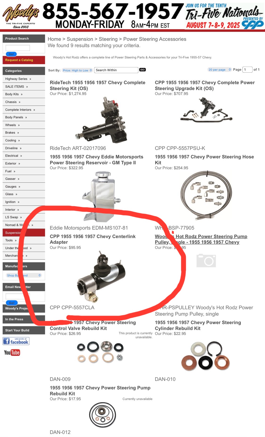

    Xman said he wants to go non power. That part I show replaces the valve assemble at the pitman arm end of the drag link.
    Seller discription IMG_3333.jpeg But what it does not say is it will bolt directly to your exciting pitman arm/steering box and drag link therefore making it manual steeeing.

    All you need is what I posted to do exactly what you just requested.
