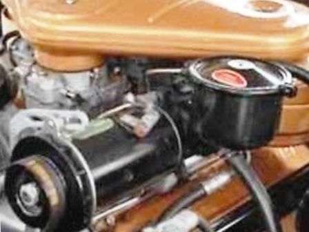

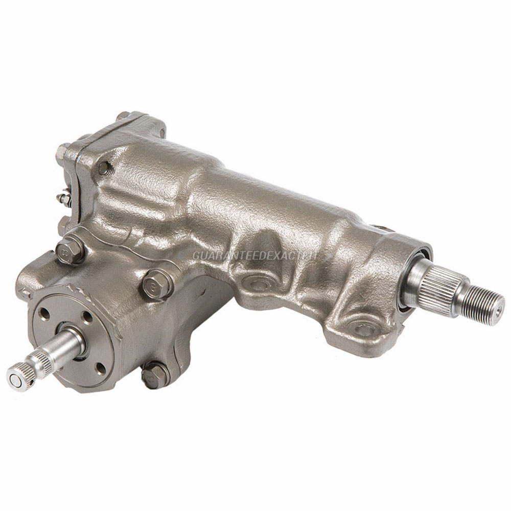

  3. 0ED8FB7D-9D04-4D6F-97A9-B80646EDBFD1.jpeg 0BA04CB1-4F75-48A4-BCD3-ED7C03757E44.jpeg Could you adapt the Chrysler setup from back then ?
    my 53 had a generator / power steering pump combo with a powered gear.
    worked good .
