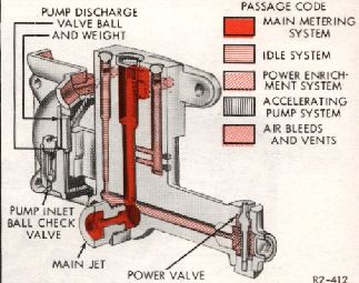

    Keep in mind the power valve determines when the extra fuel comes in on demand, not how much. That is governed by the power valve channel restrictors underneath the power valve.
    Basically the PVCRs are just fixed jets. Unless you live at a high al***ude or have a performance camshaft a 6.5" or 7.5" is going to be more than close enough. It is a good idea to see what the steady cruise vacuum for your particular engine is if you're picky.

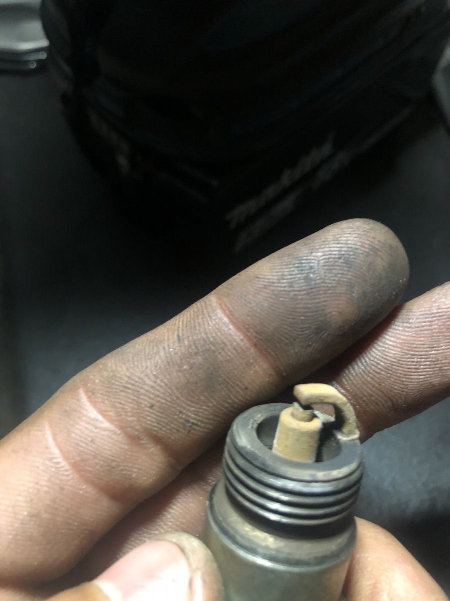

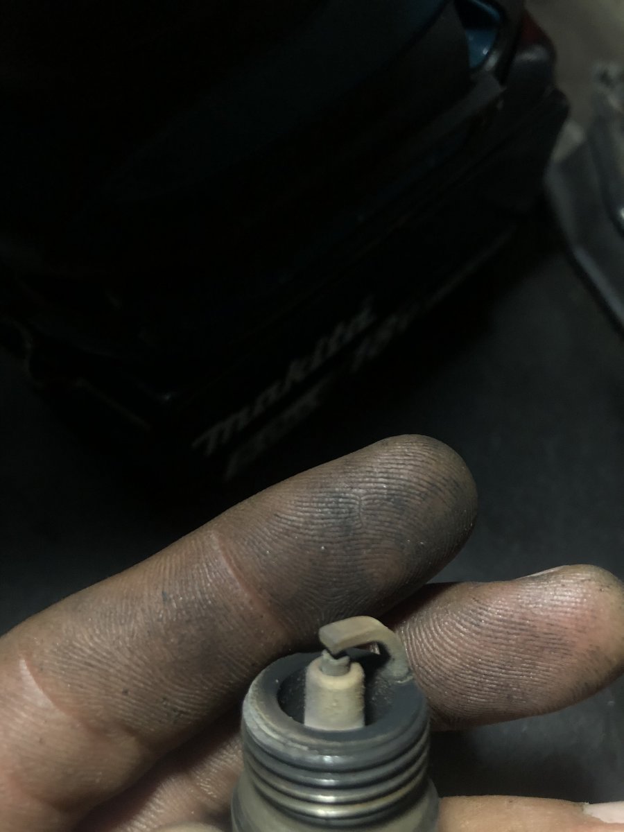

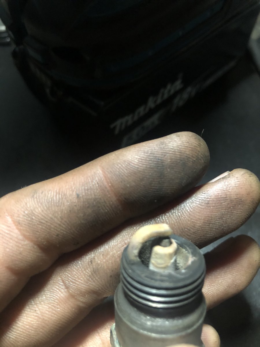

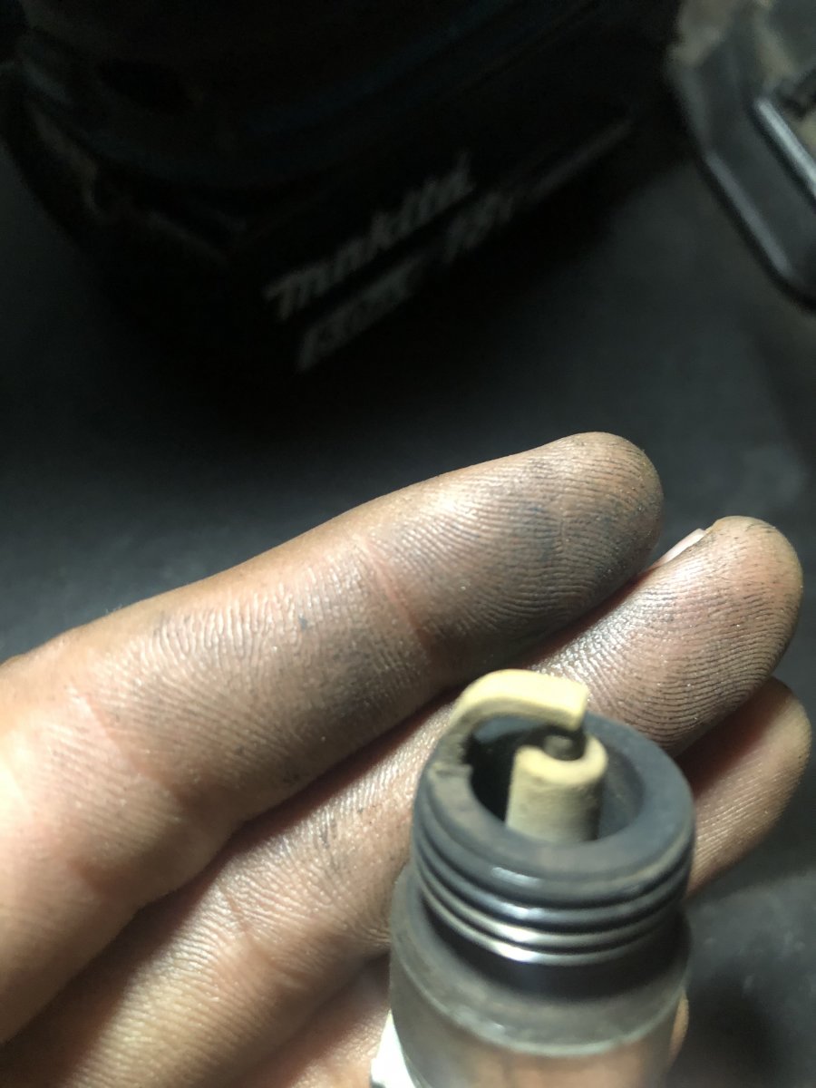

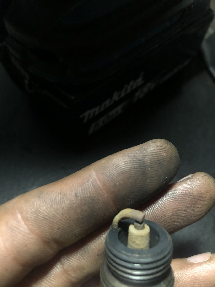

    The plugs have a few hundred miles and with the richer jet they were a darker brown while now they’re a bit more lighter brown and cleared up around the porcelain and ground strap. When it was warmer out I could tell it was a bit too rich, I’m just looking for a middle ground jet.

    It is really tough to read spark plugs with modern gasoline. They are going to look pretty lean even when running fat. It's a lot better though to run a little bit on the rich side of the air fuel ratio as it is safer.
