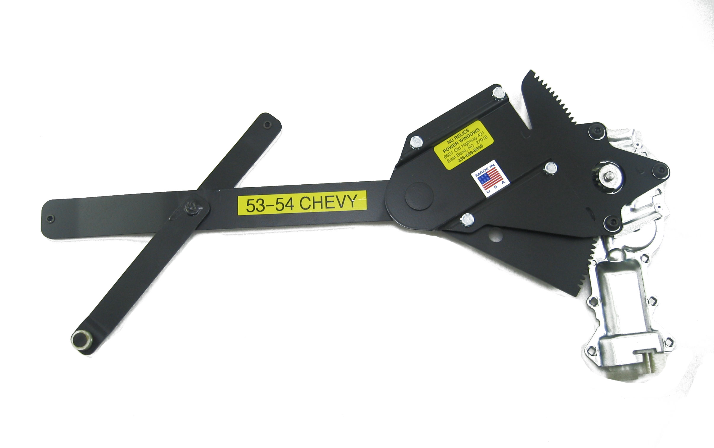

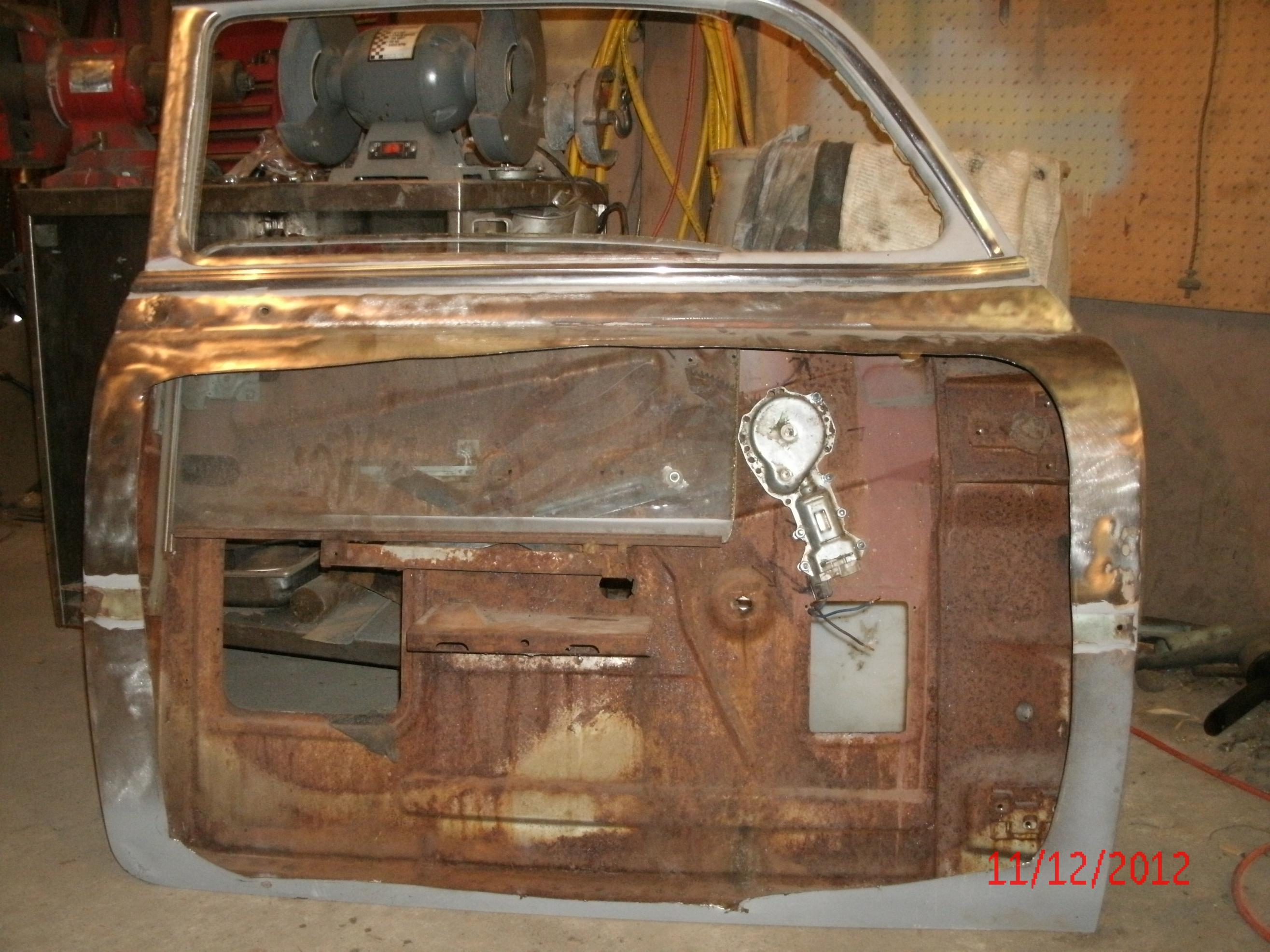

    i'm trying to adapt camaro power motors to my regulators. something like the pictures.

    Sure hope I don't have to make an opening like that on mine to make it work......!?!?!

    yeah, got bored figured that would make it easy. just a old door had laying around. wanted to see it work . the door was rusted on the bottom.

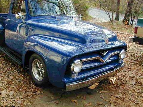

    My 55 f100 had power windows....took a square ford motor ( have lots of them) and meshed them with the orig ford regulators....these worked great for 8 years until I sold the truck...

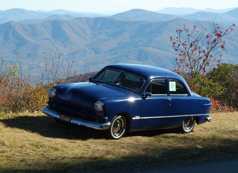

    My 51 ford had the same set up on the pass side only....worked great for 8 years until I sold it...
