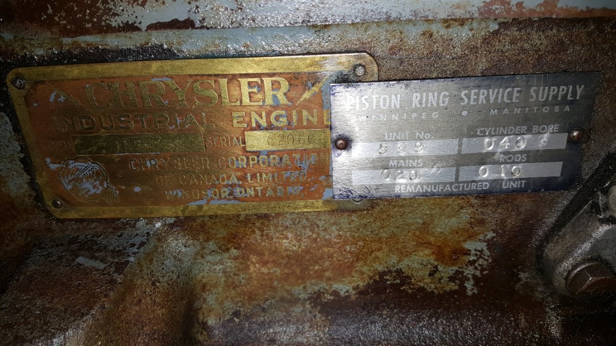

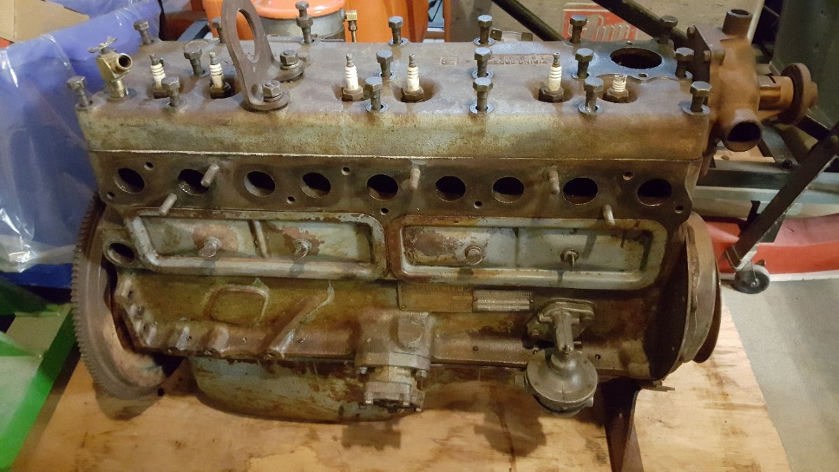

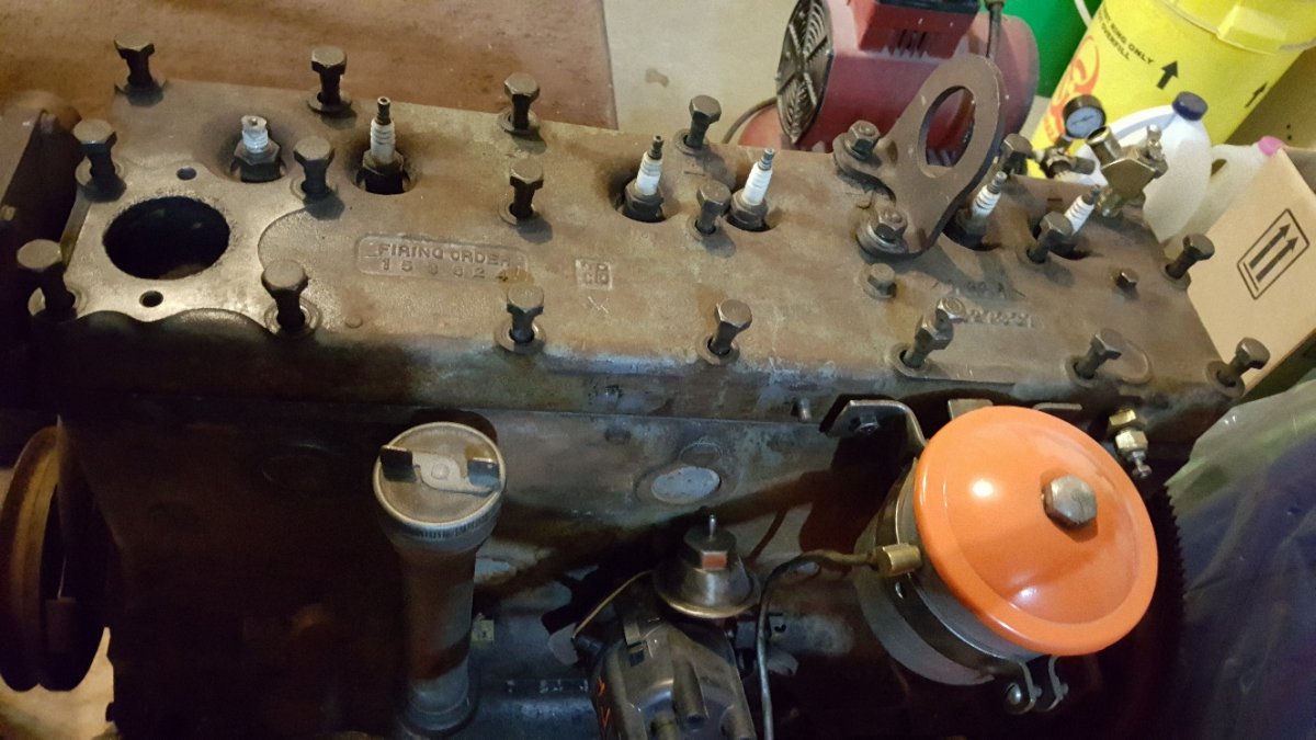

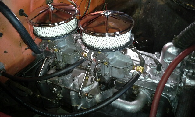

    Yes its a lot lower than peak HP which is near 3600 RPM
    Chrysler Flathead 6s have peak torque from the factory from 1200 RPM to 1400 RPM, long stroke engines undersquare and peak torque just off idle.
    My current engine is a 228 long block, dual carbs and exhaust, other wise stock, cam is stock, cam profiles change torque to the needs.
    The Chrysler flathead 6s have a very low RPM peak torque band, much lower in RPM than a Furd Flathead V8 or Stovebolt 6.
    My current old tired engine has a bore of 3 3/8 and stroke is 4 1/4, my donor 265 engine is 3 7/16 bore and 4 3/4 stroke.
    The 265 has peak torque of approx 228 ft lbs at 1200 RPM stock...

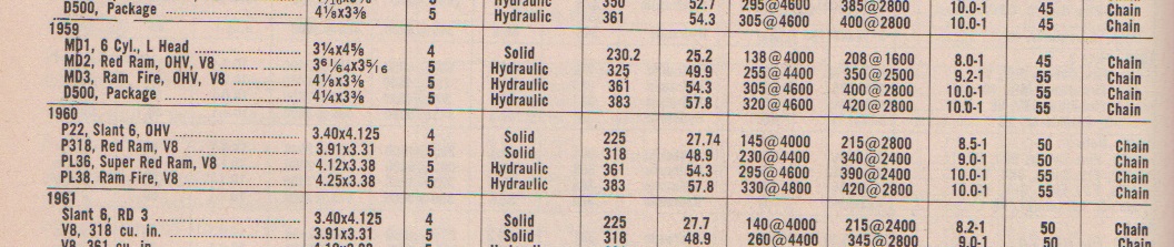

    Interesting thing is this too Jim.
    The 230 L head, in the early 1950s had like a 102 hp, and by the end of it's reign it was near 138 hp.
    The biggest change was the compression and head, and to a lesser degree some had a 2bbl carb and intake.
    Now take the slant 6, basically not much difference in the l head 6 and slants bottom end, but the overhead valve head makes a big difference.
    The nice thing about the Chrysler L head 6s is this, balanced forged cranks, full pressure oil, bearing inserts, 6 exhaust ports.
    Limiting factors 3 Siamese intake ports, where a single carb is the least efficient and a triple carb intake can be the best.
    I do know going with my 265 is going to push my little Fargo around a lot better than my old tired 228...thanks for your Time...
