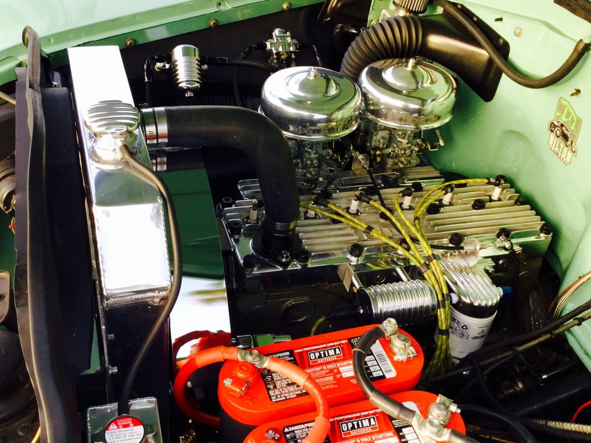

    image.jpeg Think you'll really like the improvement with performance and drivability. The overdrive is the key. My motor runs about 1800 at 65mph and the engine responded to the card/intake/exhaust/head..
    6inarow likes this.

  20. JOHN H EDGE
    Joined: Dec 8, 2015
    Posts: 407
    JOHN H EDGE
    My motor is smaller than what your building I have a 218 bored .040 but compared to stock it is a world of difference
    The acceleration from 0 to 55 allows you to run with traffic and
    Easily cruise at 75 and actually p*** vehicles. The carbs really improved drivability. I drove this wagon for about 1 year before doing the motor. It's now a pleasure to drive
