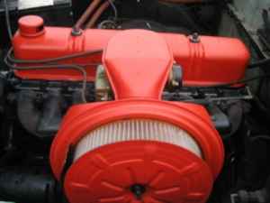

    ...check out that snorkel air cleaner on my 223!

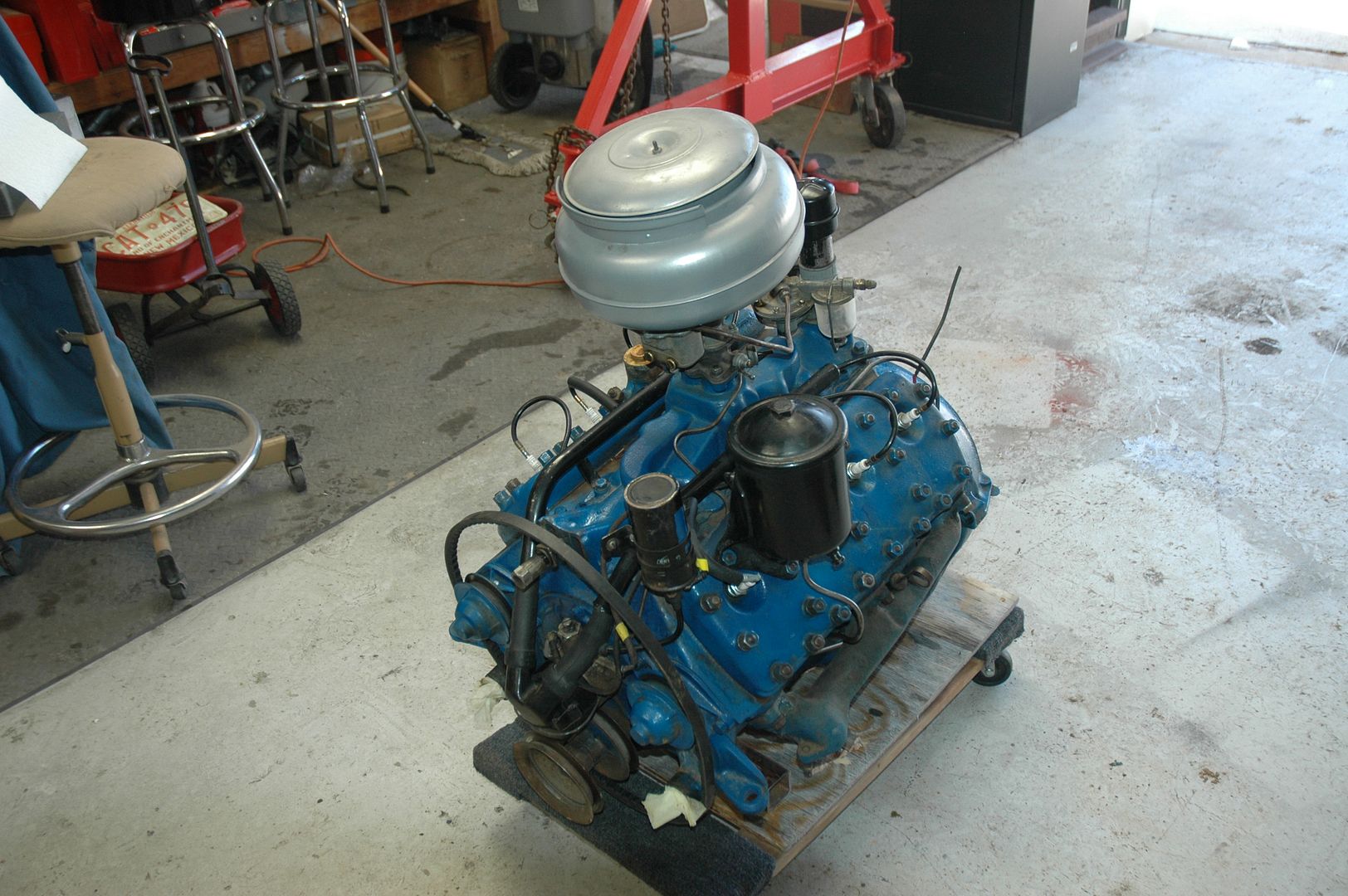

    Whoa!! That's sweet did you make it? Or what's it off of?? the disc part looks like the center out of a late 50's MEL air cleaner I've got...

    This V12 is a 292 CU from a 1948 Lincoln which is the better block to use as the water jackets are better for water flow.

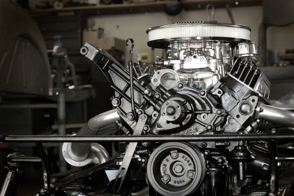

    Here is my 351W in my 1960 Falcon.

  24. Falcon Gasser
    Joined: Aug 29, 2007
    Posts: 940
    Falcon Gasser
    Edelbrock dual quad R.P.M.
