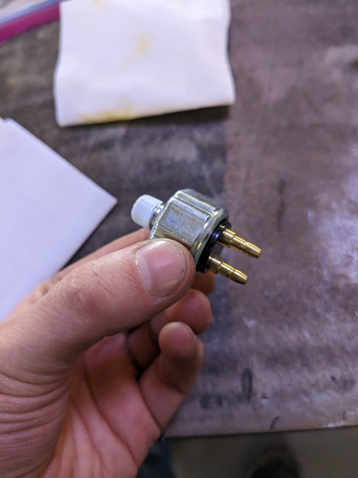

  5. tmd171
    Joined: Jan 9, 2013
    Posts: 25
    tmd171

  9. ClayMart
    Joined: Oct 26, 2007
    Posts: 7,937
    ClayMart
    The switch pictured a few posts back appears to have teflon sealing tape wrapped around the threads. Could a piece of that gotten loose and pushed inside the switch? Maybe try installing a new pressure switch with nothing on the threads.
    tmd171 and caprockfabshop like this.
  10. PhilA
    Joined: Sep 6, 2018
    Posts: 2,125
    PhilA
    Those switches are terrible. The aperture seems to be the right size to trap dirt- once it gets in it tends to pack the diaphragm and cause it to be sticky.
    Might be it's just oil canning with the heat and making contact.

  17. caprockfabshop
    Joined: Dec 5, 2019
    Posts: 698
    caprockfabshop
    If every single switch was in the same batch, then in theory they're just grabbing the next one in the box to ship to you.
    Post up a pic of the switch and how close the exhaust is to it. That could be effective functionality as well.

    from Detroit
    It's the switch. I drove the car, light came on. Tested the switch with an ohm meter, switch was closed. Removed the switch (no pressure behind it), tested again - still closed. Put it in the freezer for 10 minutes and it tested open. Junk, just like everyone has been saying. Now the hunt begins for a modern pressure switch !
    VANDENPLAS and Johnny Gee like this.
