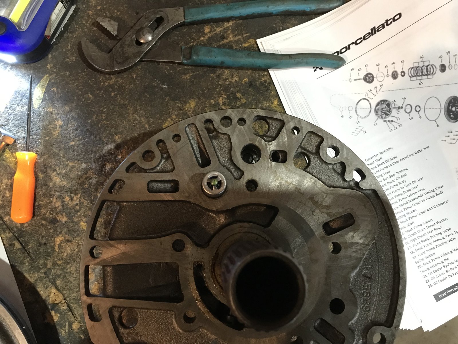

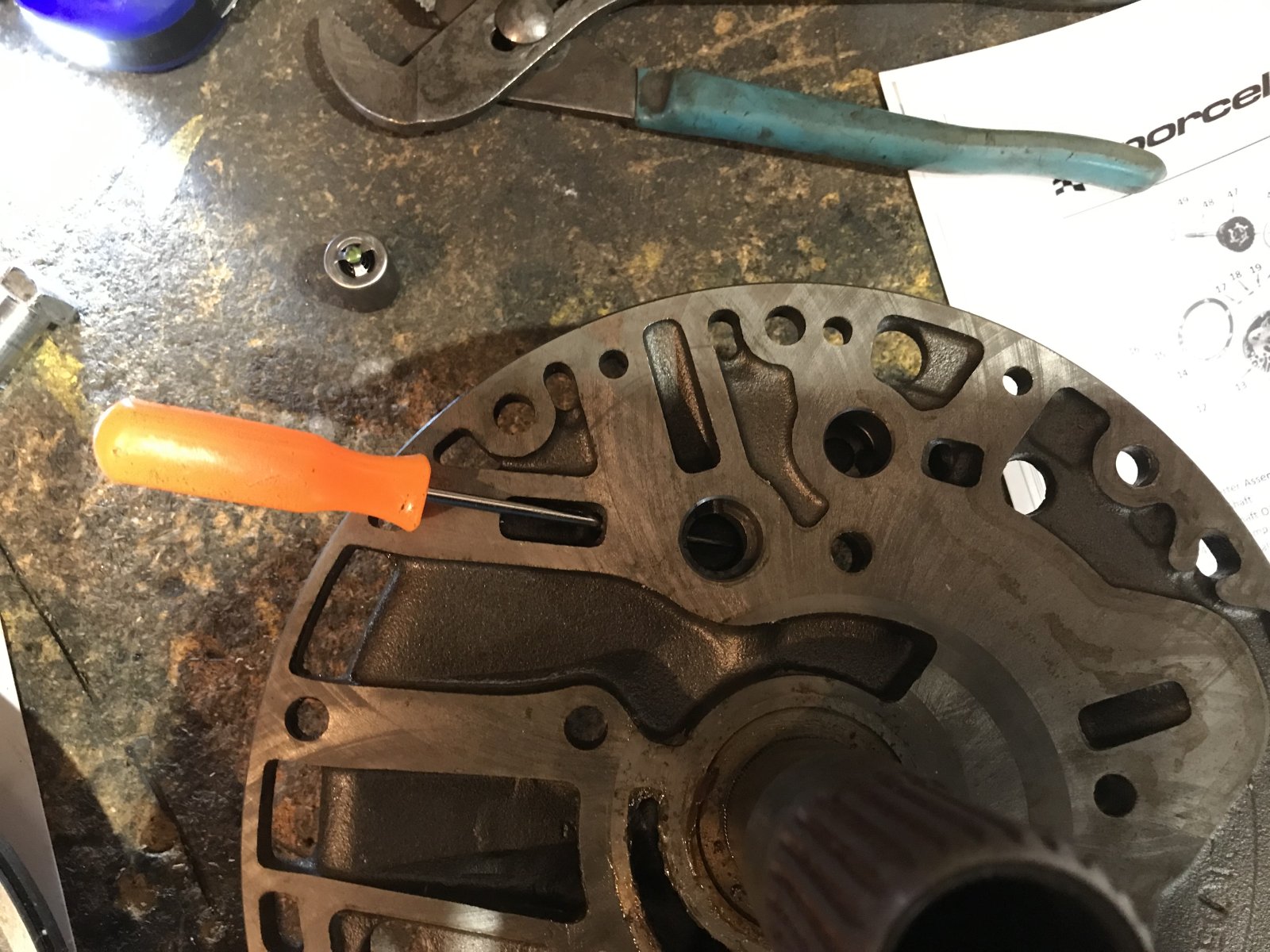

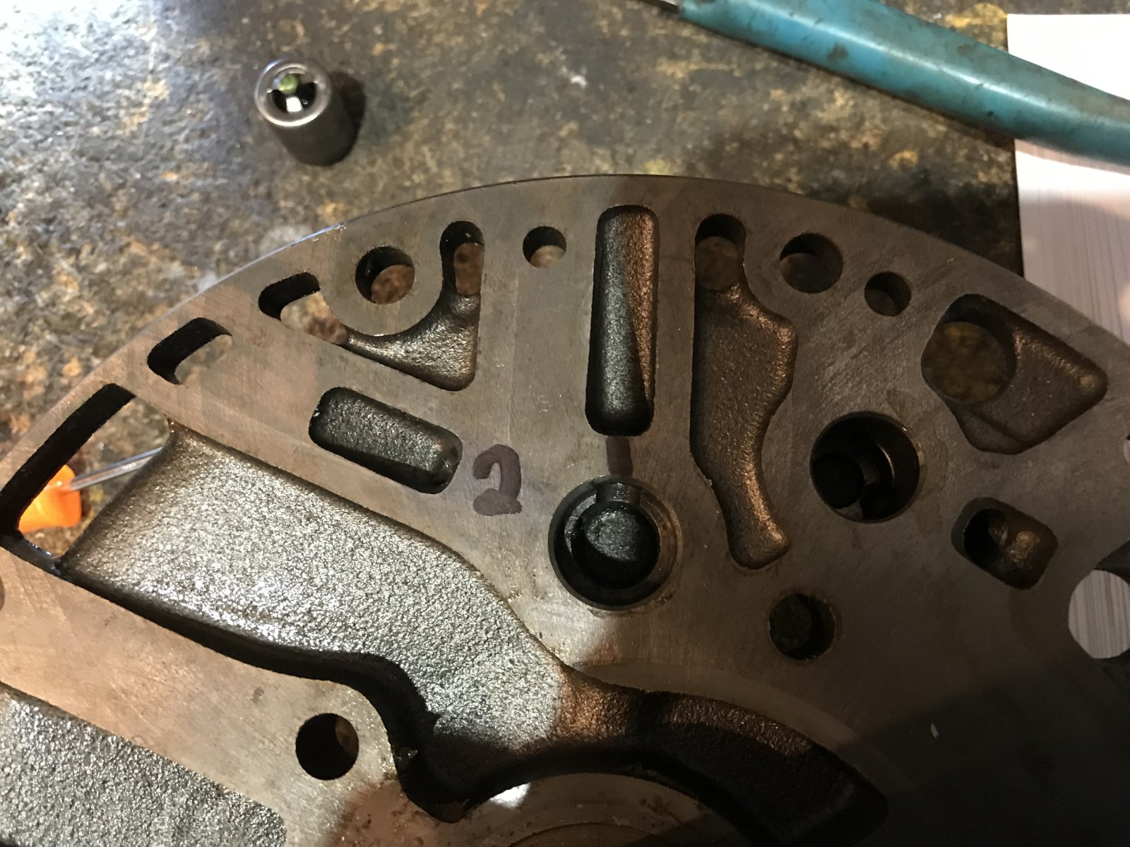

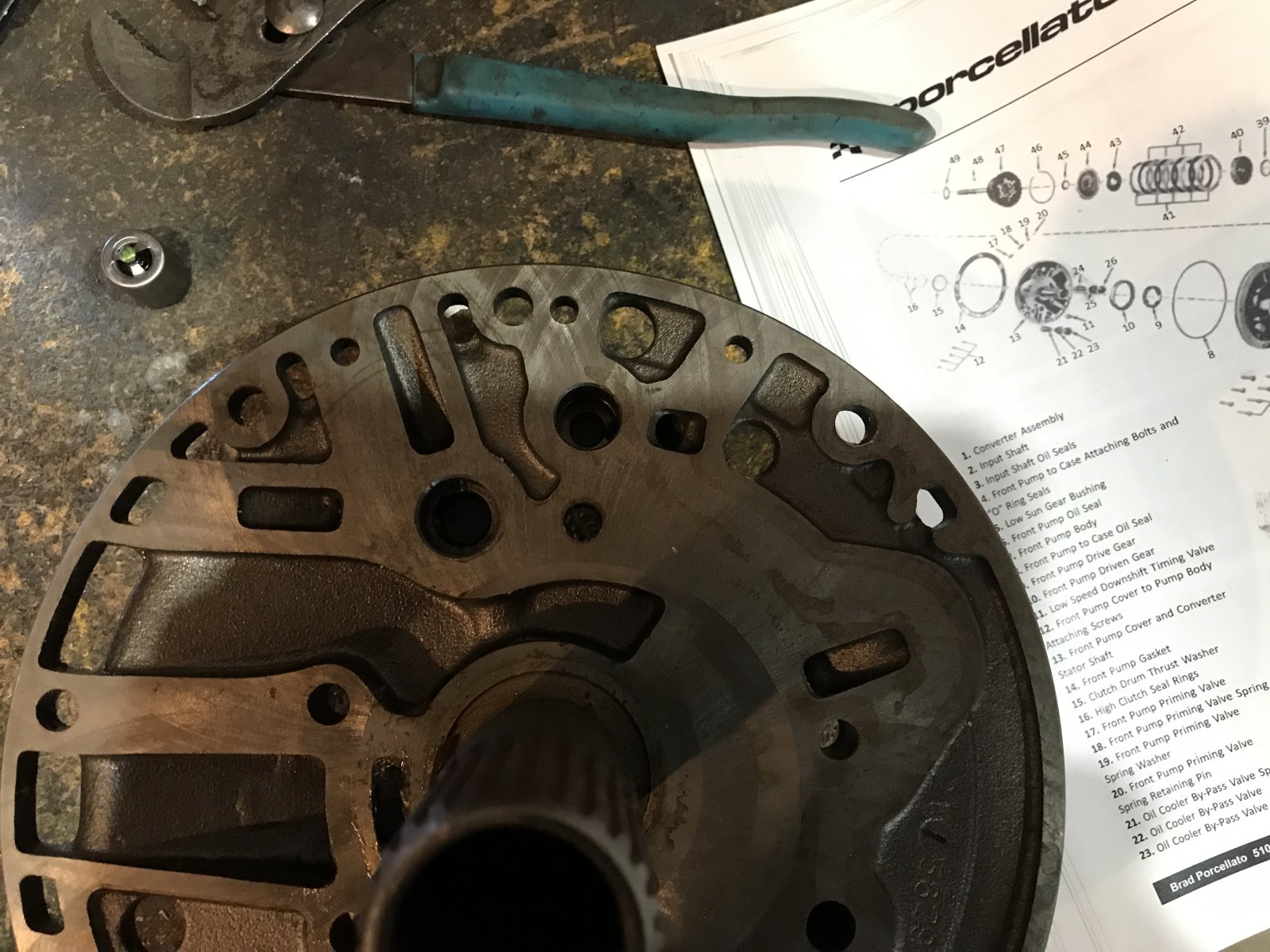

    Folks, I am rebuilding an air cooled Powerglide. I would like to modify to have fluid to cooler Radiator, below are some pictures of the pump, and valve. Which hole should be plugged.

    So I guess that is not the cooler byp*** valve. There is nothing where the valve goes. What do I need to do to get external cooling

    I think I only worked on one air cooled powerglide and this is one modification that I have never done. From what I gather, if the case is drilled for cooler lines, you just have to hook them up. One thing I found says that the cooler by-p*** valve is taken out of the air cooled units. This would mean that you would have to install one or the oil would completely by-p*** the cooler. Another says that it is there and simply opens with the flow from the air cooled convertor. In either case, the oil coming out of the convertor is used to lubricate the gear train so you need to insure that you have flow.

    willys36
