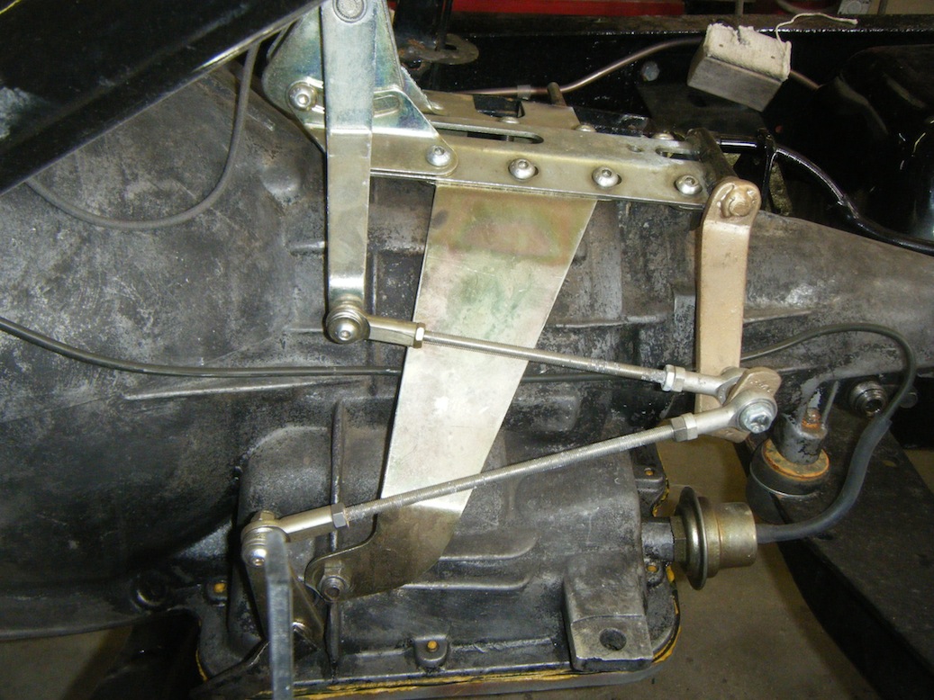

  15. i see you solved your problem, but i thought i would post a picture of the linkage i made for a powerglide, to get the shifter mounted all the way forward. works perfect.
