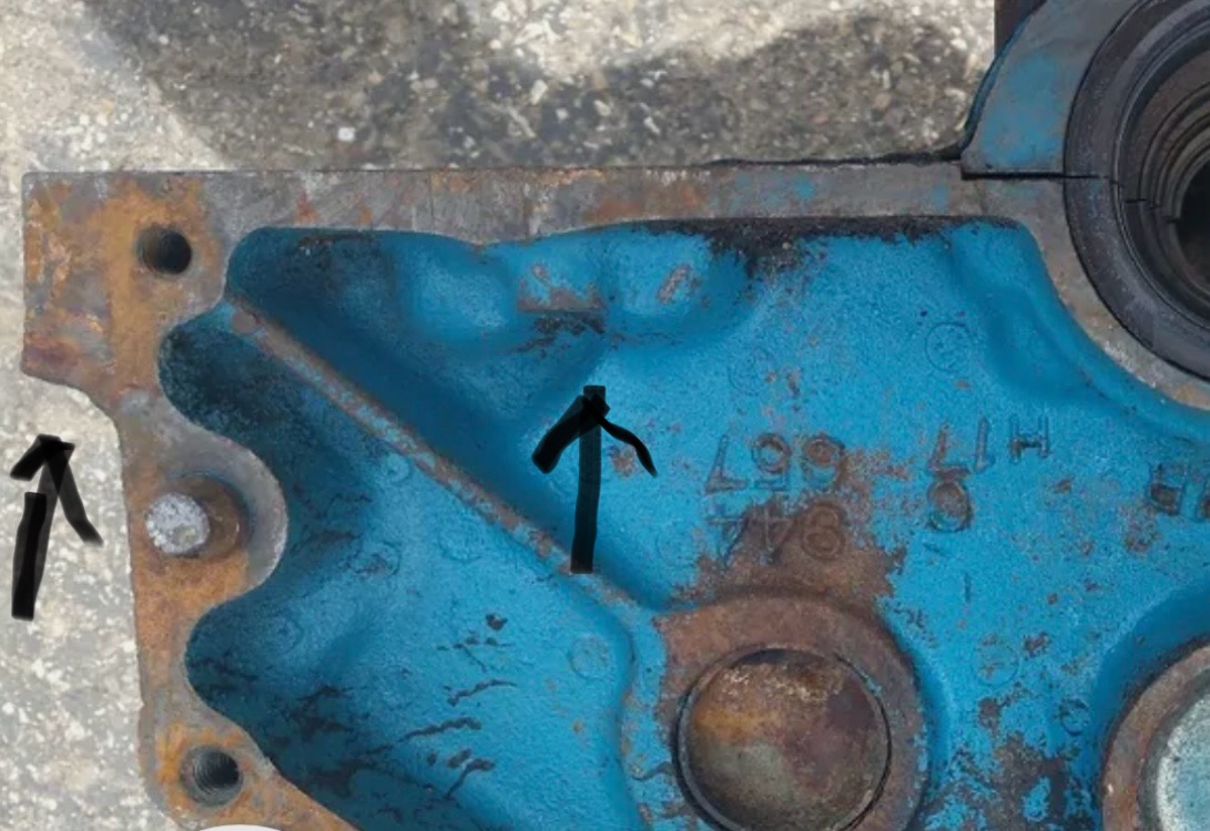

    Now here’s. later block (327). Note the starter holes upper right. IMG_2480.jpeg

    Looks like 2 holes could be drilled, but the third not so much.

    That’s the thing. Is casting made thicker in those area’s like in later years??? I think not.

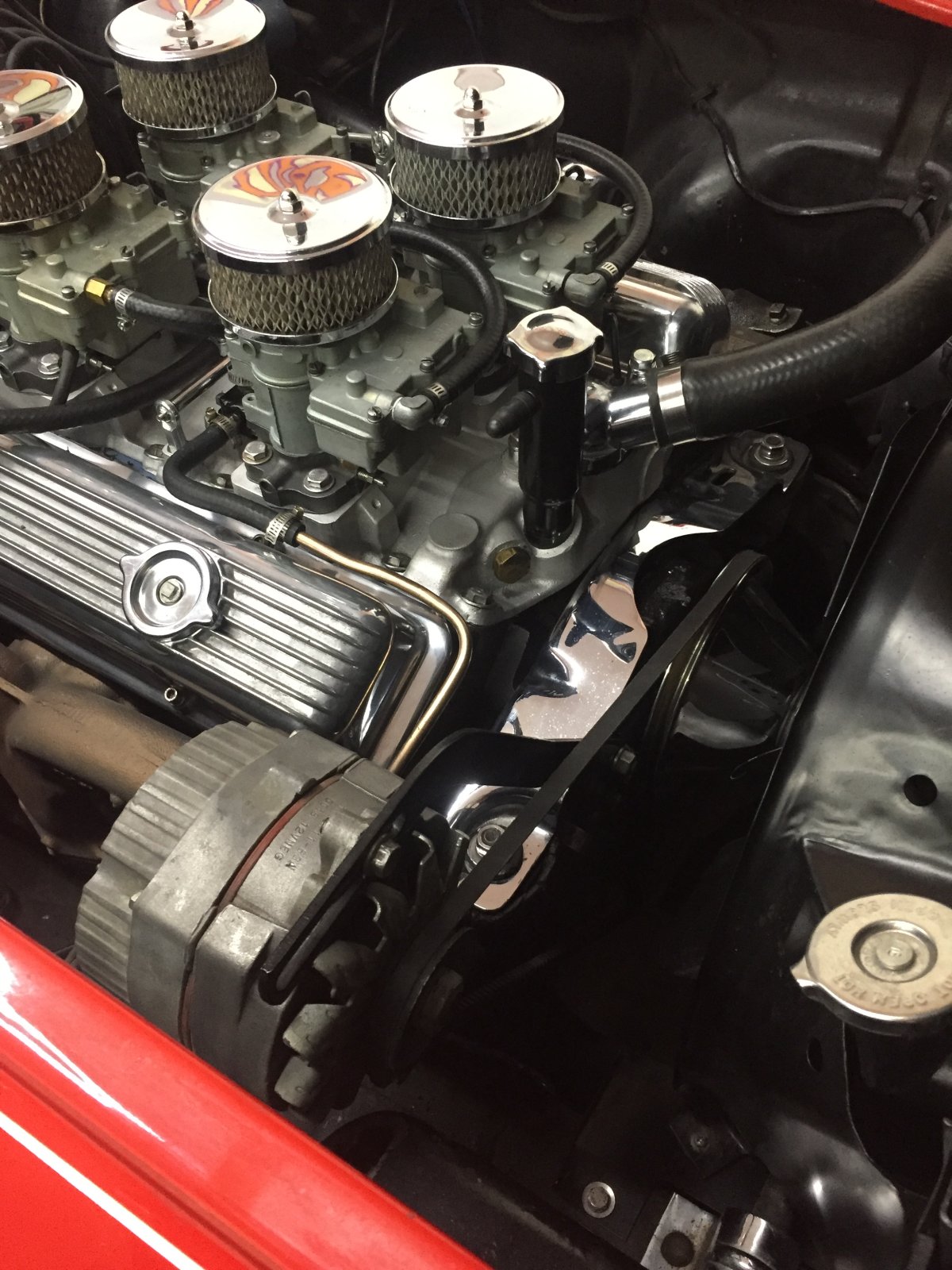

    were those thru the water pump bolts?

    Perhaps on the Vette….but the aftermarket mounts dipped below the crank pulley and came up along side and utilized the same threaded bosses on the front of the block that the stock p***enger car ‘pedestal’ mounts attached to, not the water pump attach points.

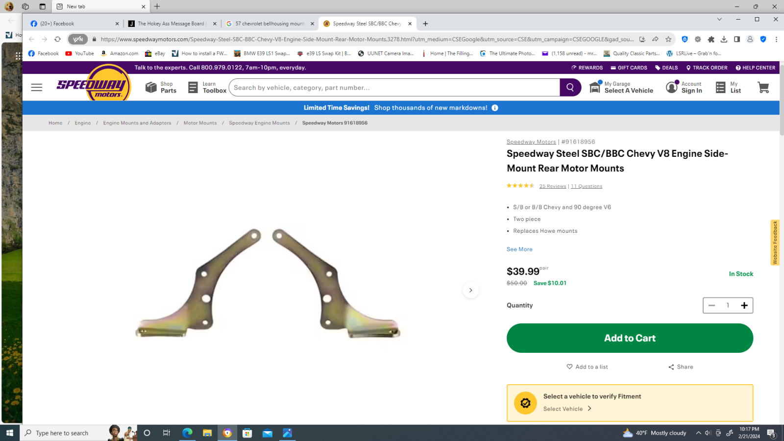

  16. Mr48chev
    Joined: Dec 28, 2007
    Posts: 36,080
    Mr48chev
    Moriarity likes this.

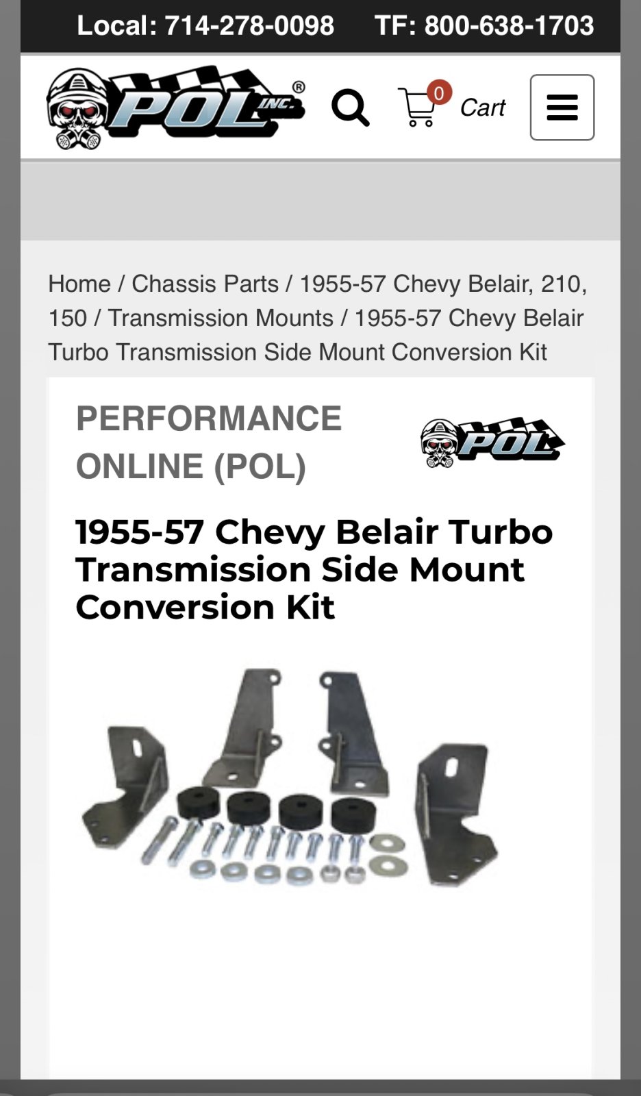

    Danchuk is probably who you’re thinking of? But since Woody’s has taken over well, things just are not the same.
    But here’s the side mount kit for later transmissions. POL is just west of where Dunchuk was. Good thing, because Woody’s is just too damn far to drive to get parts. IMG_2486.jpeg
