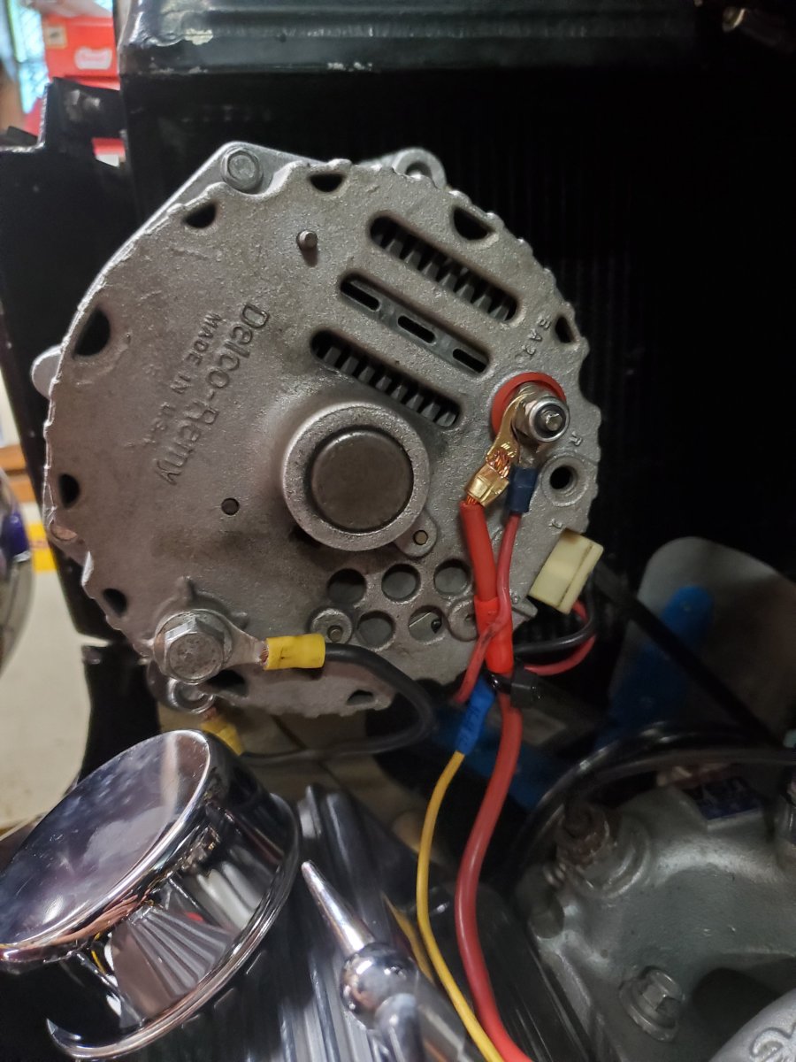

    This is the Delco

    One other thing to do to improve your alternators useful power output is to wire the sense wire to the main power bus.
    Currently it appears the sense wire(red) is wired directly to the Bat terminal.
    10si or 12si, wiring the sense wire to the bat terminal directly is robbing yourself of proper power output to feed your electrical components. It effectively turns your Alt into one wire, which gives poor power response/output for a street car that has several high load(amp) switching components.
    A 3 wire alternator needs to monitor electrical load to keep power requirements satisfied. Even with a 10si, bringing that sense wire to the main bus will greatly improve your current power issues.

  30. MAD MIKE
    Joined: Aug 1, 2009
    Posts: 1,078
    MAD MIKE
    What are you referring to? I see nothing backwards.
    On the back of your alternator there is the large BAT terminal and large charge wire. That should go to charging your battery(+) terminal, sometimes it goes to the main bus of your electrical system, depending on how your vehicle is wired.
    Note: Move the insulation of the large wire back onto the ring terminal crimp, there isn't much space there and can easily cause a short if it gets pushed against the case. Normally there is a little ****on that goes over the BAT terminal to prevent shorting.
    Nothing other than the battery charge cable should be on the BAT terminal.(!)
    Smaller red wire that is part of the two terminal plug on the side of the alternator.
    Red wire is the 'sense' wire, it monitors system voltage. To properly function it needs to be monitoring the main bus voltage, not the alternators(BAT terminal) voltage.
    Bring that little red wire out to where you have your electrical loads powered from. Be it the starter solenoid, fuse box feed, or wherever you have your main tap in for electrical power. There should be a singular location of electrical power feed and not multiple taps in the system.
    Even with the current 10Si, relocating the 'sense' wire to the main electrical power junction will greatly improve upon your current issues. And this will need to be done regardless if you change to the 12Si or not.
    Current 10Si can only put out a max of 63A if it is the high output variant. It also could be a 42A unit which would be grossly under-powering your system.
