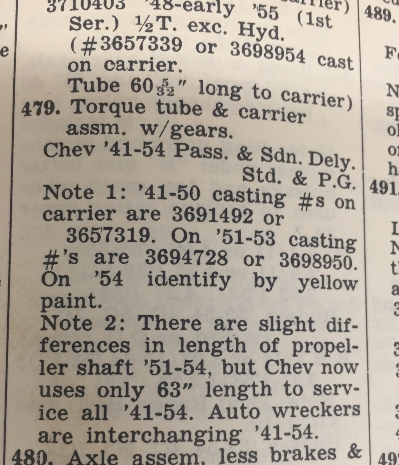

    I looked it up in Hollander and they fit from 41-54.
    90403E00-BAD7-4C60-854A-79CDE9DC4CFA.jpeg 12CBFC3B-34BB-4A77-A275-67F26F183F8E.jpeg

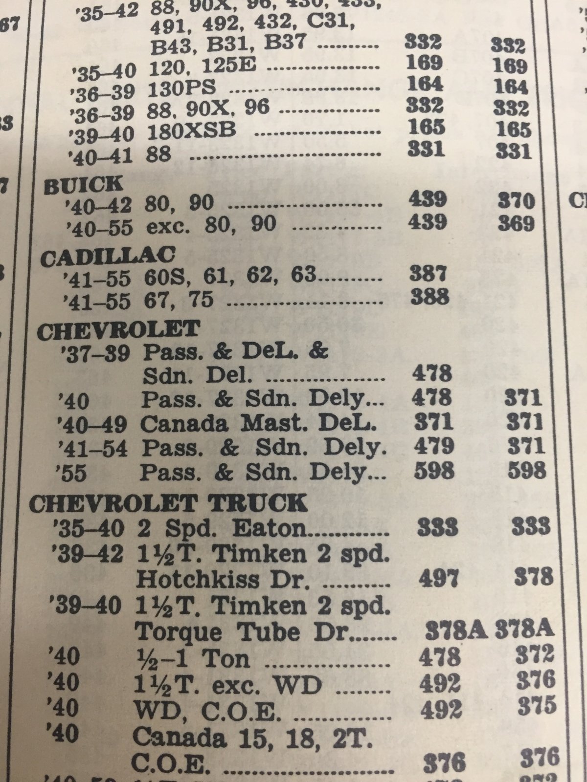

  7. Moriarity
    Joined: Apr 11, 2001
    Posts: 38,197
    Moriarity
    SUPER MODERATOR
    I looked your truck up in Hollander and it is a 478, here’s what it says
    1DD92A2E-5B7A-407A-ABD5-0B2549BB844A.jpeg EF18455F-30F0-4C96-A00C-773BF36EC145.jpeg
