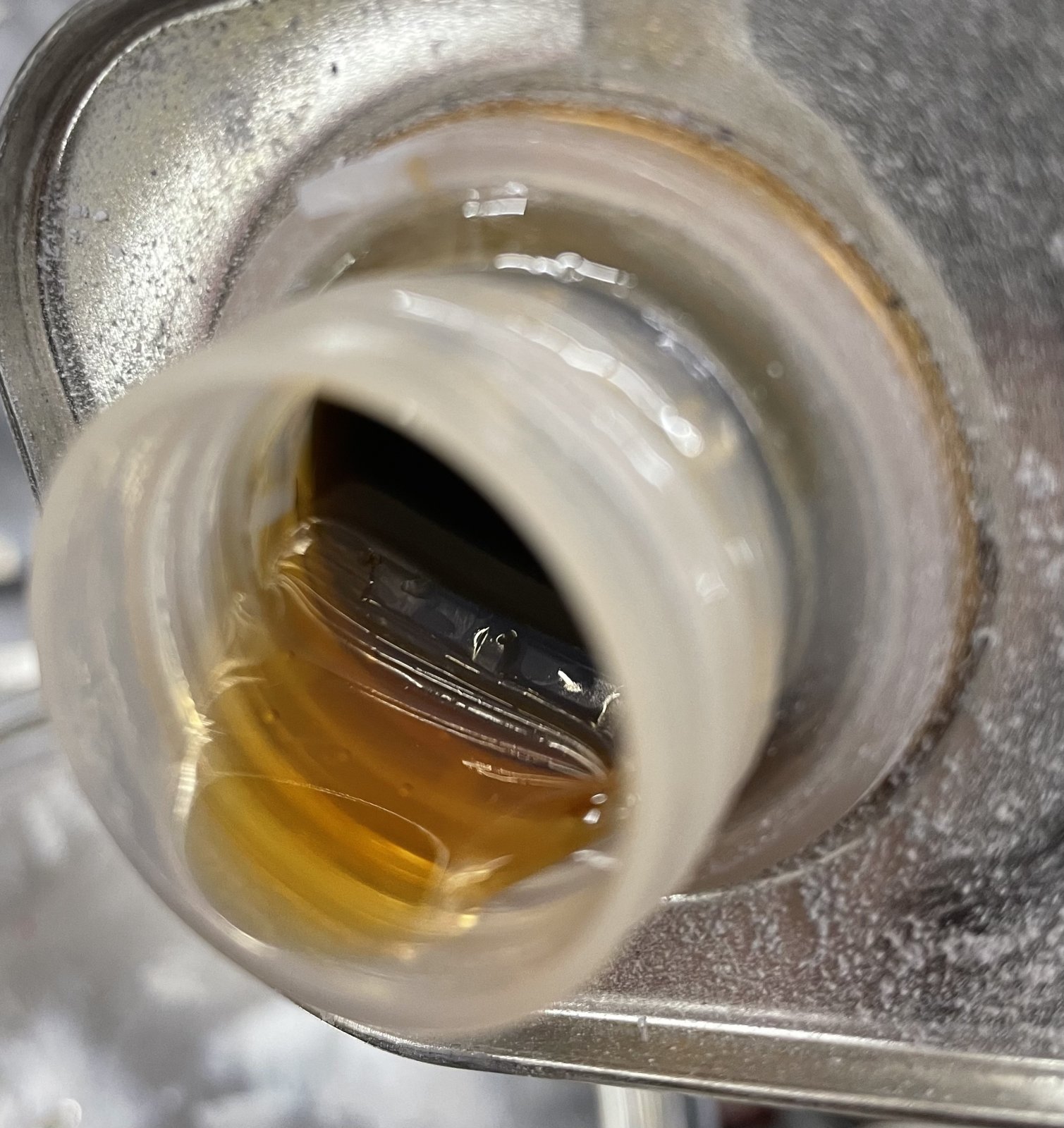

  18. Here is the catalyst
    It’s thick like STP
  19. ronzmtrwrx
    Joined: Sep 9, 2008
    Posts: 1,458
    ronzmtrwrx
    Looks like it. The CRE catalyst is like mol***es right out of the fridge. :D

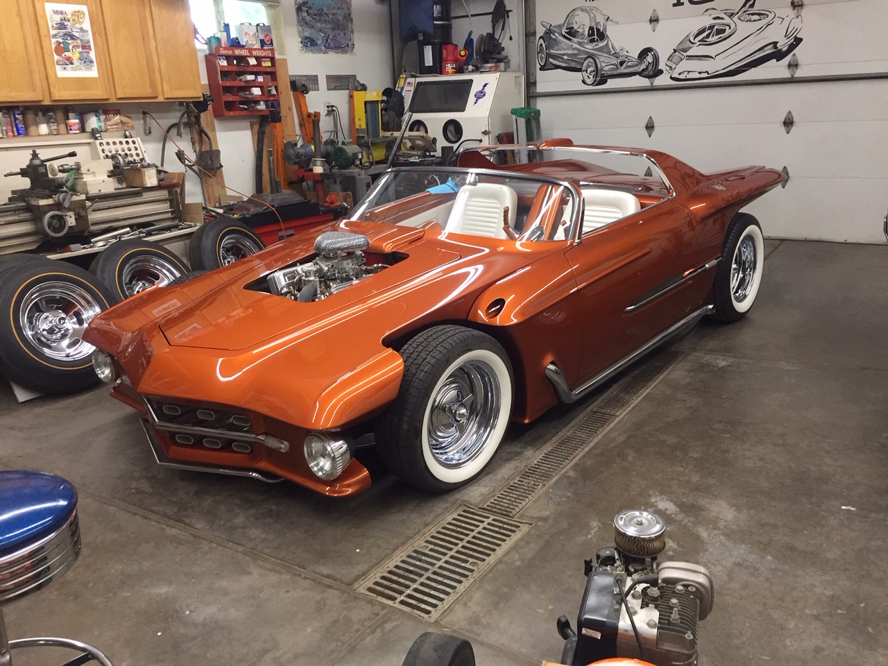

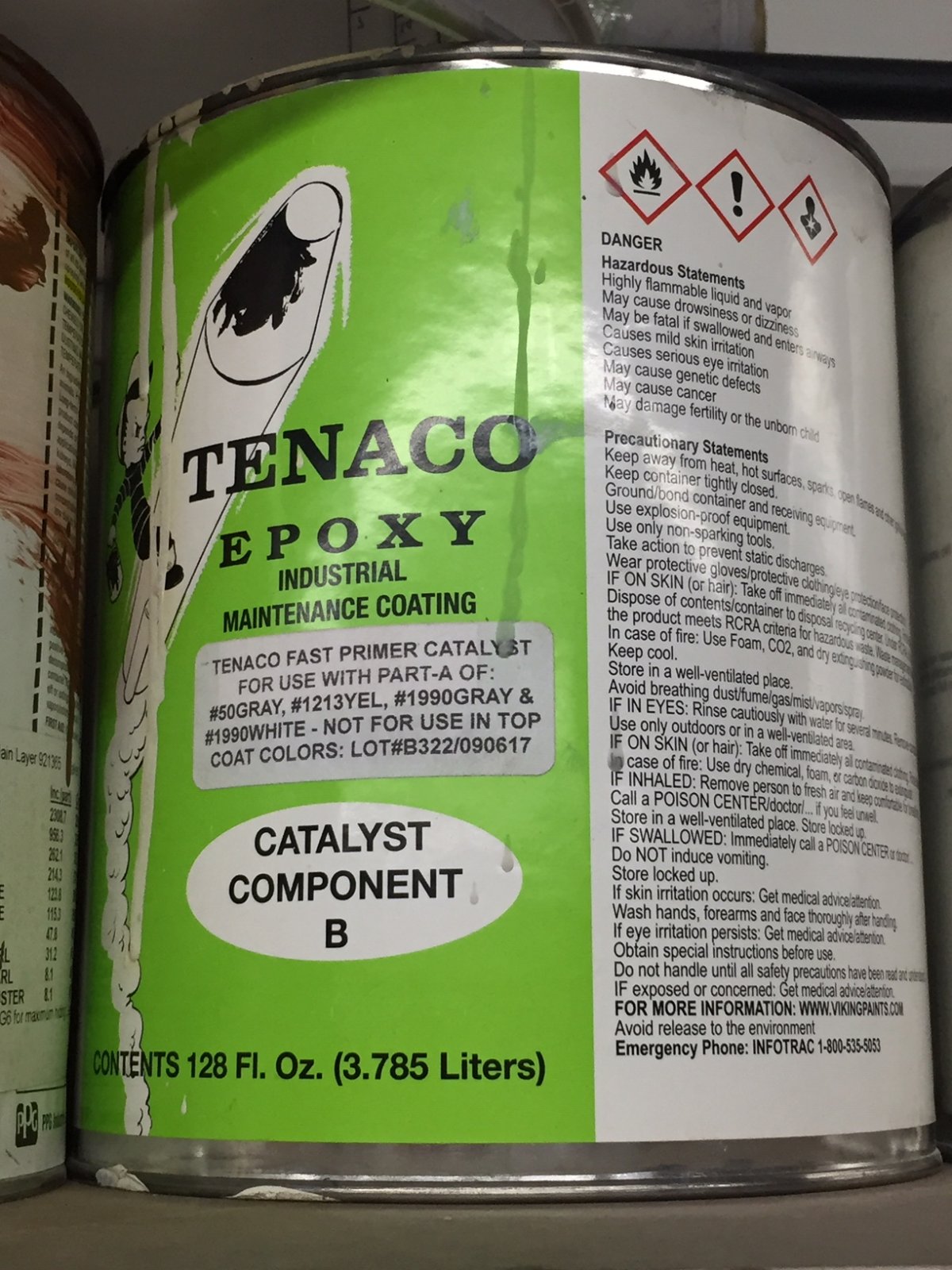

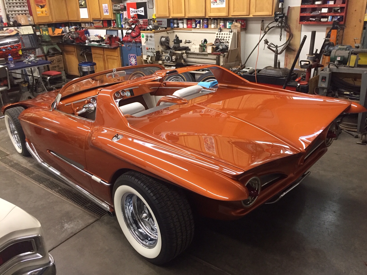

    I use Tenaco epoxy. It is the same stuff that Squeeg's hot rods buys and re labels. really good stuff, high build easy sand but because it is epoxy you have to wait 2-3 days before sanding. Denny used this material exclusively on the Predator showcar that I own and he painted it in 2015 and there is zero sand scratch swelling and zero shrinkage of any kind and that car has a ton of custom bodywork. it has been a couple of years since I bought some but 2 gallons sprayable was 150 bucks tenaco.JPG denny5.JPG denny7.JPG
