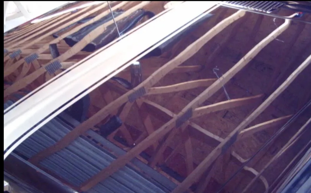

    Indeed, prep. I'd rather pick n file for a day than spend 3 or 4 days making dust. I'd rather go home feeling good vs going home feeling like I got caught bangin the fat chick under the bleachers. Nothing against fat chicks mind you...;)
    This feels good. The whole car has 1 swipe of metal glaze on 1 small metal finished patch.

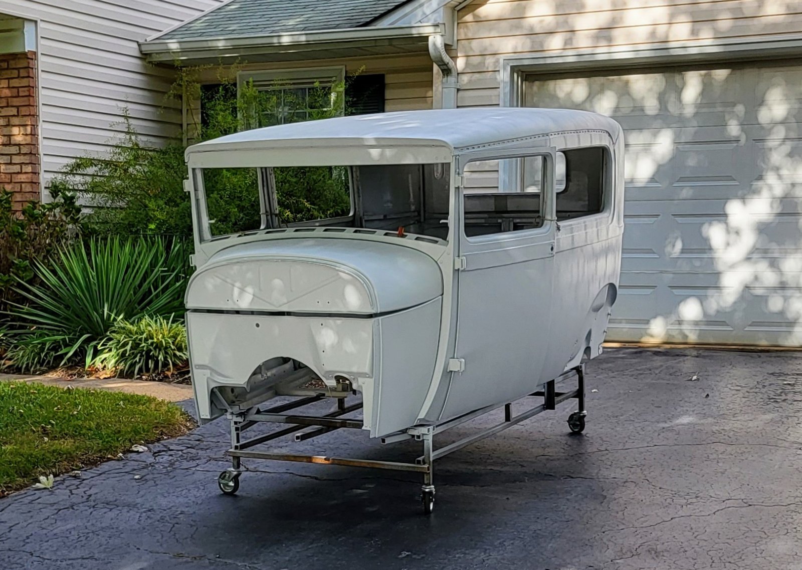

    I’m about to start on a blasted cab. Using one undercoat throughout the project is an interesting concept.

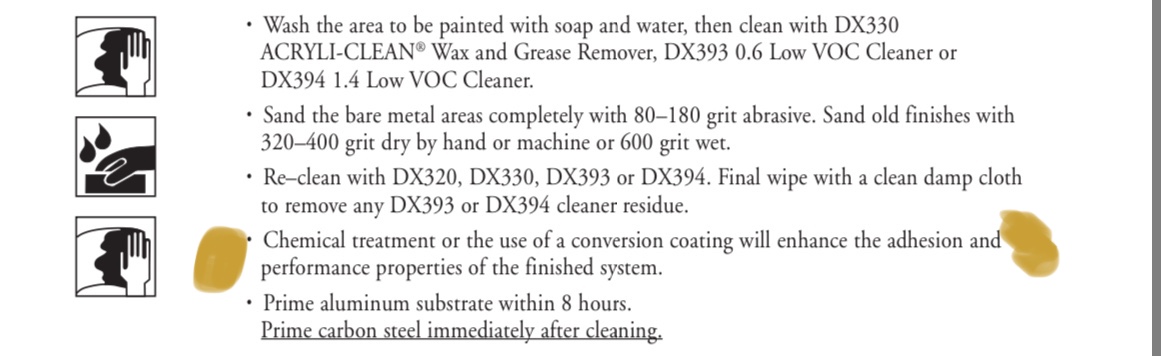

  23. I’ve read several epoxy tech sheets that have a phrase kinda like this “for best adhesion use **** metal conditioner/cleaner”
    We used the ppg DX cleaners back in the day.
    I’ve used em on brookville bodies.
    The 2050 doesn’t mention a metal conditioner/cleaner. The DP does last time a looked.

    mentions using epoxy immediately after blasting
    And using metal treatments on bare DAd steel before using epoxy

  28. Nope. I teach this stuff to high school students. I read tech sheets, guides, best practices, go to training seminars, ask dumb questions on top of doing this stuff for 30 years. I like to answer questions when asked.
    Clean, etch, urethane I’ve done a zillion times
    But I’m curious on the subject of metal conditioners. At one shop when I first started, DP was applied over metal prep. Then that changed to etch/urethane.
    Then when I got back into resto work, epoxy was the main product used but not the metal preps.
    I’ll ask a paint rep and get a grin and shrugged shoulders.
    In the guide if you continue, it goes over the various PPG epoxies. Then you check the tech sheet. The 2050 doesn’t mention metal preps but DP did the last time I looked.
    This is the reason for the curiosity.
    now, the 2050 info doesn’t mention it’s an epoxy but the catalyst, dry times …… are very similar to their epoxy products.

  30. That particular line is omitted from the 2050
    differed from the DP
    I guess this is where the curiosity on my part started
