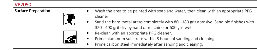

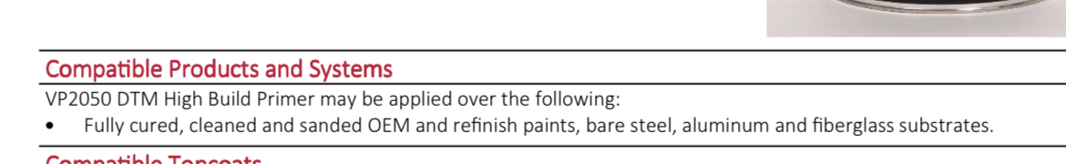

    There are 3 or 4 Tech Sheets for the VP2050 primer and this one has the reference:
    The PPG Logo and VIBRANCE COLLECTION are registered trademarks of PPG Industries Ohio, Inc.
    Date: 8/2013
    VP2050
    DTM High Build Primer
    Product Information:
    VP2050 is a gray, two-component 2.1 VOC DTM High Build Primer which provides excellent adhesion and corrosion
    resistance to properly cleaned, sanded and treated steel, galvanized steel, and aluminum substrates. VP2050 provides
    excellent direct to metal properties important in today’s restoration and custom market.
    https://us.ppgrefinish.com/getmedia...ab/201308_vc_VP2050_shop_en.pdf.aspx?ext=.pdf

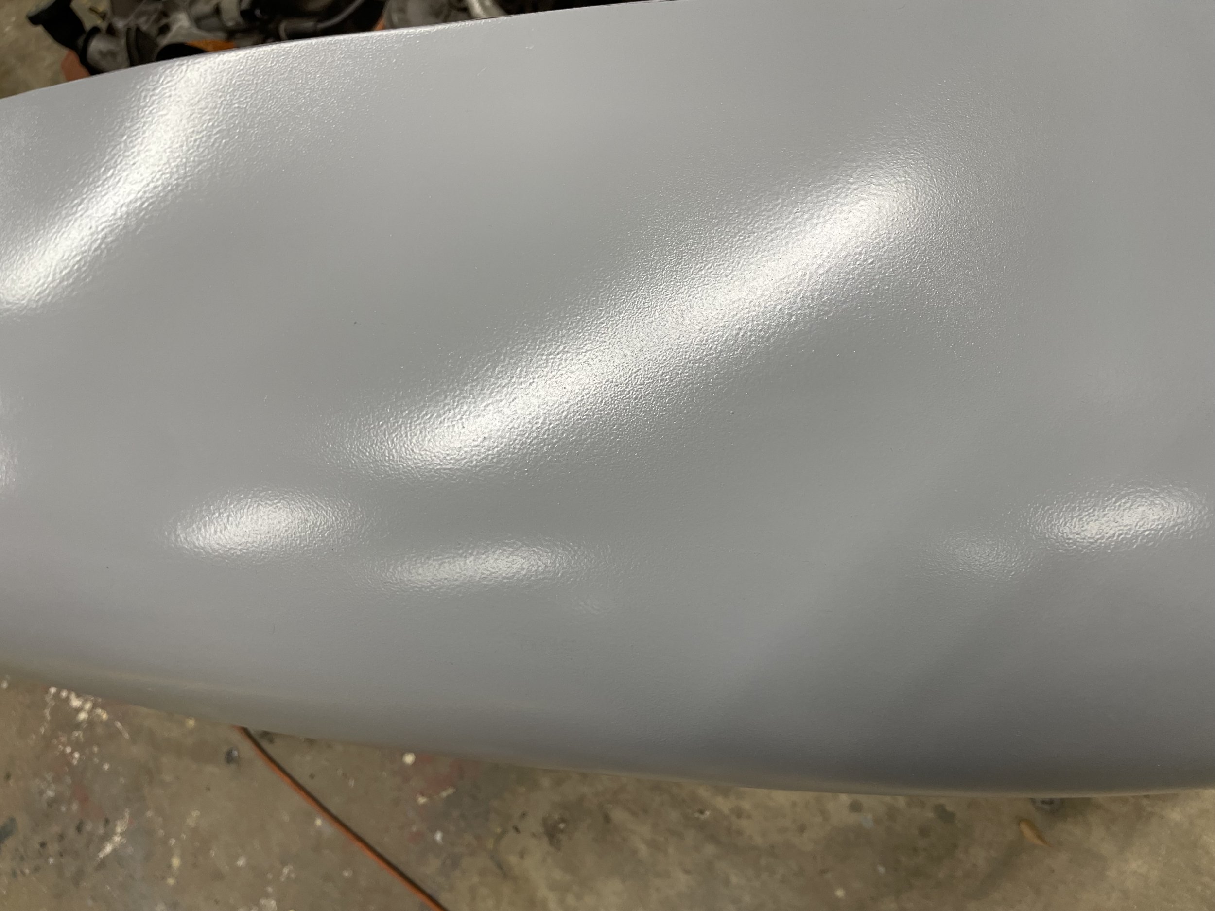

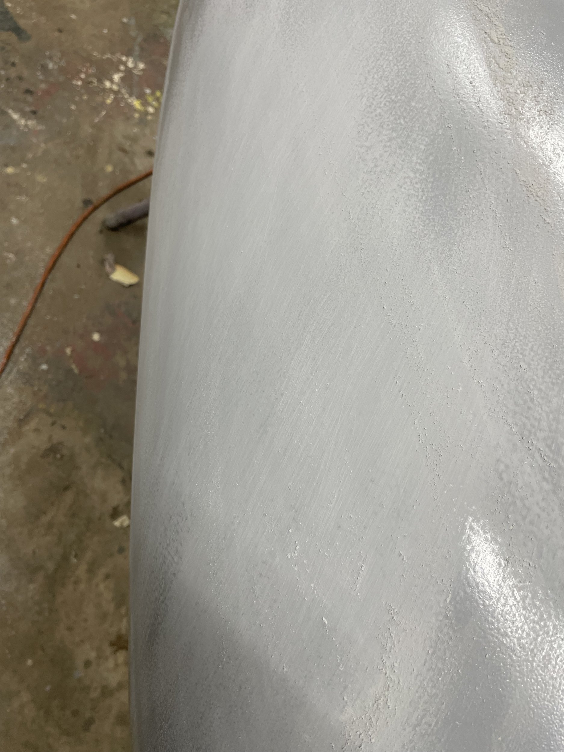

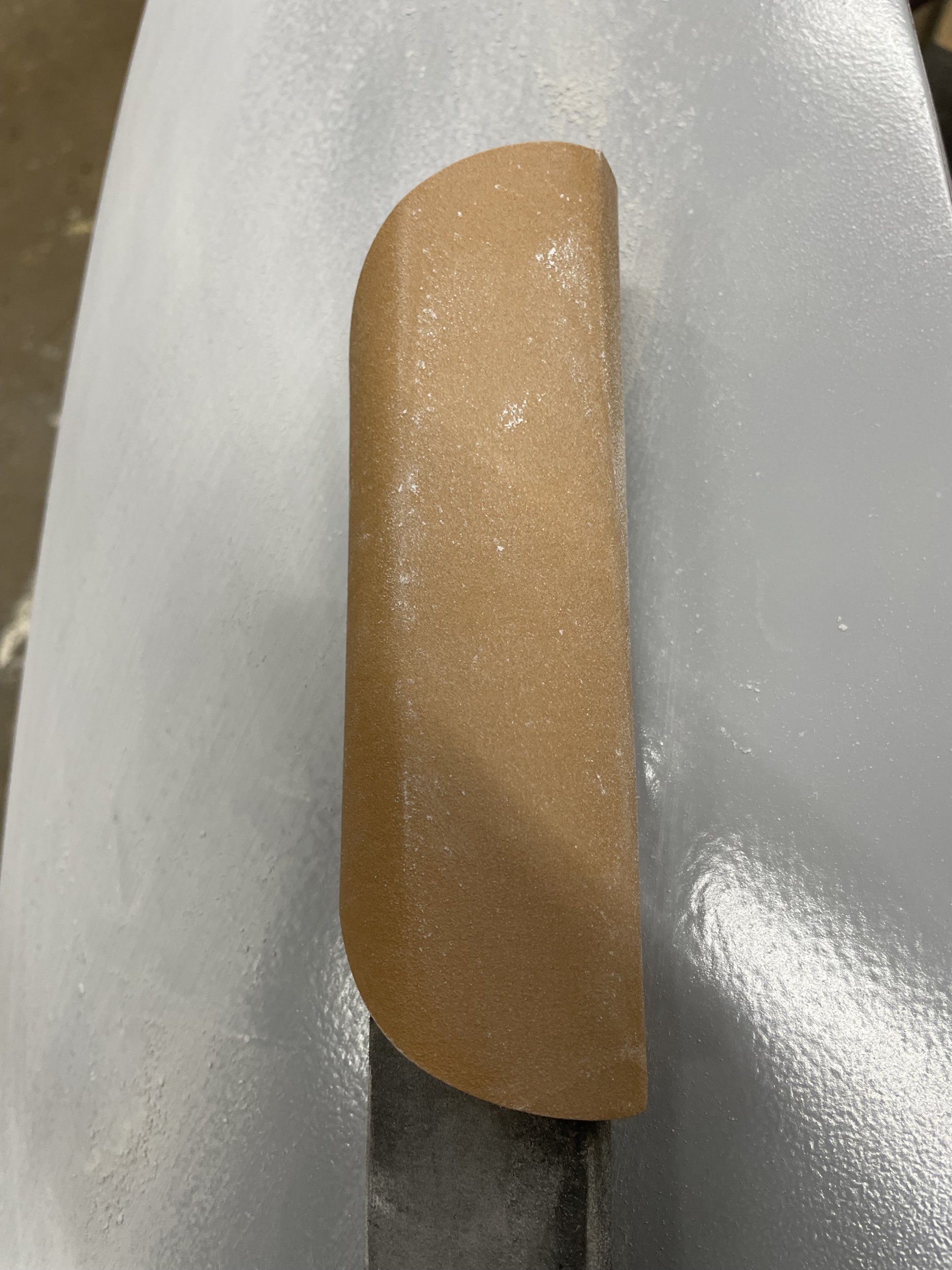

  17. Used the VP 2050 again this week.
    This time shot with a 3m gun with a2.0 tip. Sprayed a lot better than the 1.4 we used last time.
    Product seems to have a good bit of texture. But sprayed by first timers as well.
    reduced 10%
    It’s been raining the past 2 days so we have 100% humidity. Primer has been applied for 24 hours. Sanded well
    Was still a little tacky this morning. Not a product for speed. Powdered up well with 220 this evening. I did put a light on it this morning.
    Probably still a tad green for sanding. But not bad for epoxy.
    edit: teamp have also been between 45 and 65

    Tip size, maybe a little reducer, flash time between coats, ambient temp-shop temp-cure time. These are critical with the very high solids (thick) material. A good reminder.

  20. Shop temp was not optimal at all
    2.0 is the largest tip we have
    TDS says a 1.8 will work so we’ll try that next.
    We did reduce it.
    That **** won’t hardly spray without it.
