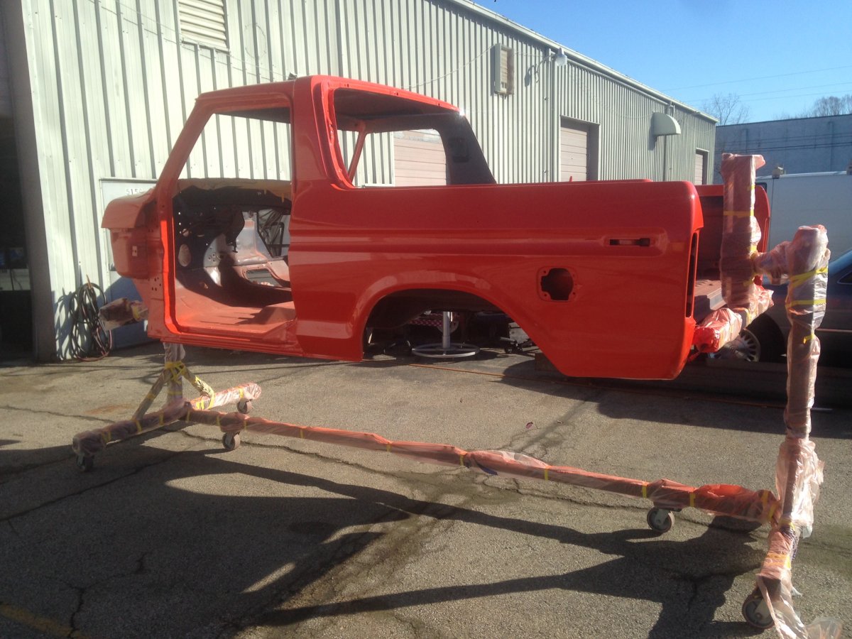

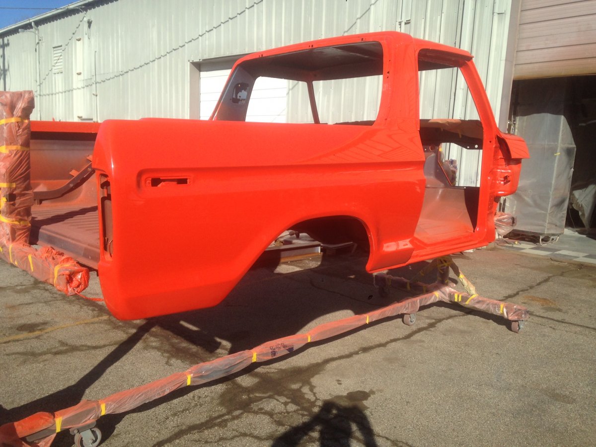

  12. Short story, awesome stuff and I'm happy.
    Long story :
    Shot my test piece, color was 1969 GM hugger orange or carousel red.
    I had 4 different prep surfaces- 400 wet, 400 dry, 320 dry, and non sanded.
    Surprised that it laid out best over the 320 dry but still great.
    IR gun showed metal surface temp at 64*
    I'm wondering how much this following "little" leaded fact has to do with anything on how it shot and laid out for me ???
    My buddy wanted a little different shade of orange, noticeable but still very slight with less red. The hugger orange paint code priced out at $165 gallon plus hardeners, the color he picked off the deck priced out at $365 gallon plus the same hardeners :eek:.
    Upon investigation- The guy at the counter said the hugger orange code used toners that are lead based and the other color used different and more expensive toners but both are solid colors- no mica no pearl nothing fancy. Now we're both surprised at that. I asked if there was any weird stuff, well how's that for weird?
    I told buddy the shade change isn't worth $200 so he's sleeping on it. I get to find out what I'm shooting today and since the other is mixed with other stuff I'm pretty sure it's bound to shoot different.
    alanp561 and henryj1951 like this.

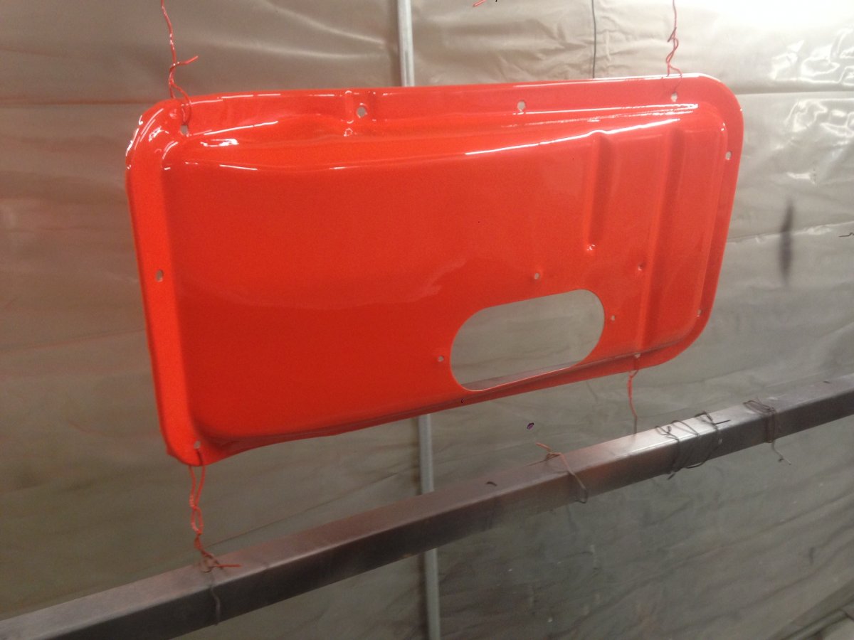

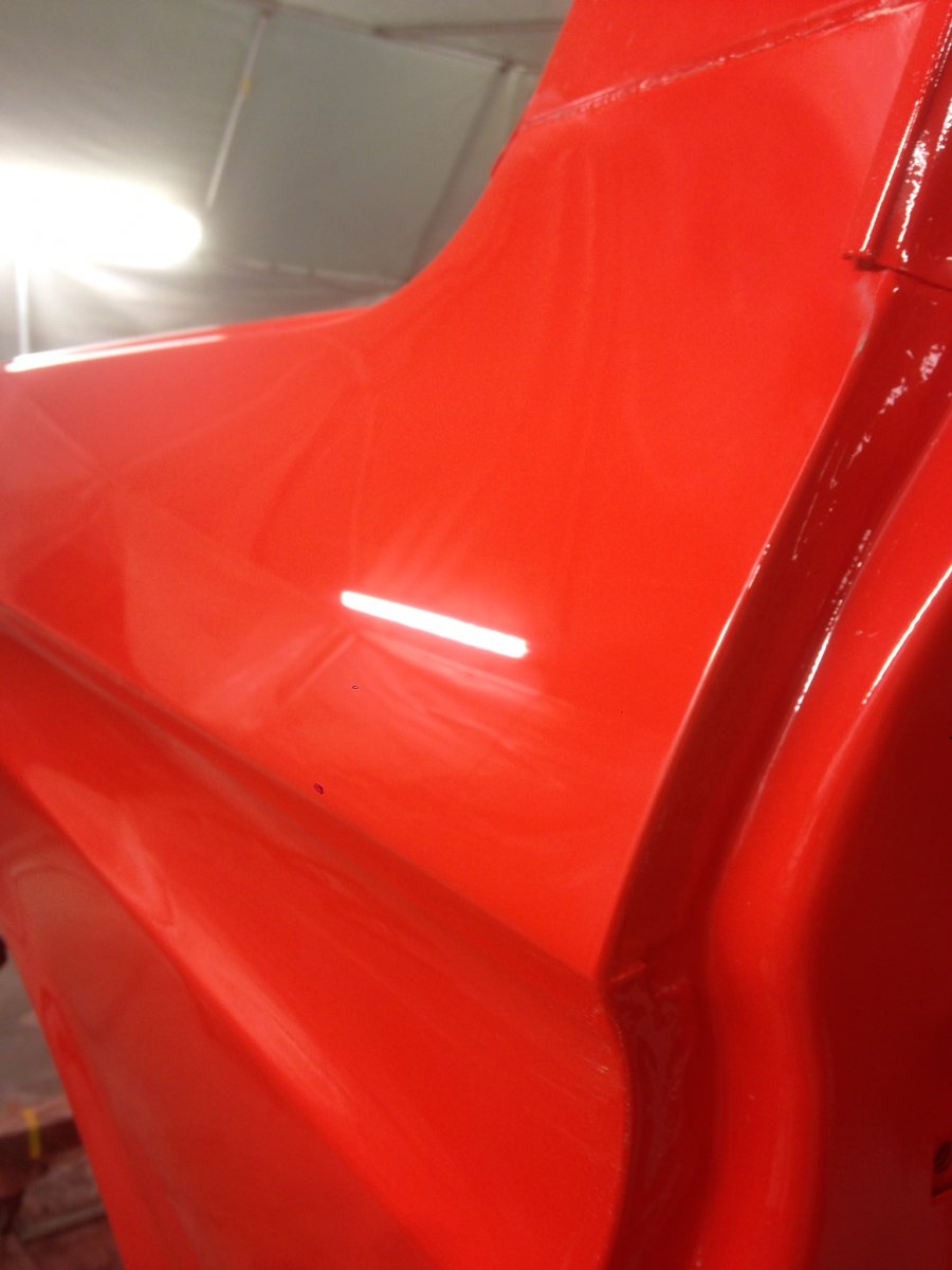

  21. If you can get your bodywork straight-and don't mind putting in IMG_9477 - Copy.JPG a little elbow grease..well..the results speak for themselves
    Hnstray and jimgoetz like this.

  24. That's some depth and reflectivity for bright orange
    fauj, chryslerfan55 and alanp561 like this.

    That orange looks great for just being sprayed with no extra handi work done on it.
  30. Bandit Billy
    Joined: Sep 16, 2014
    Posts: 15,715
    Bandit Billy
    Looks like it flowed out nice! Any sags or runs you care to admit to?
