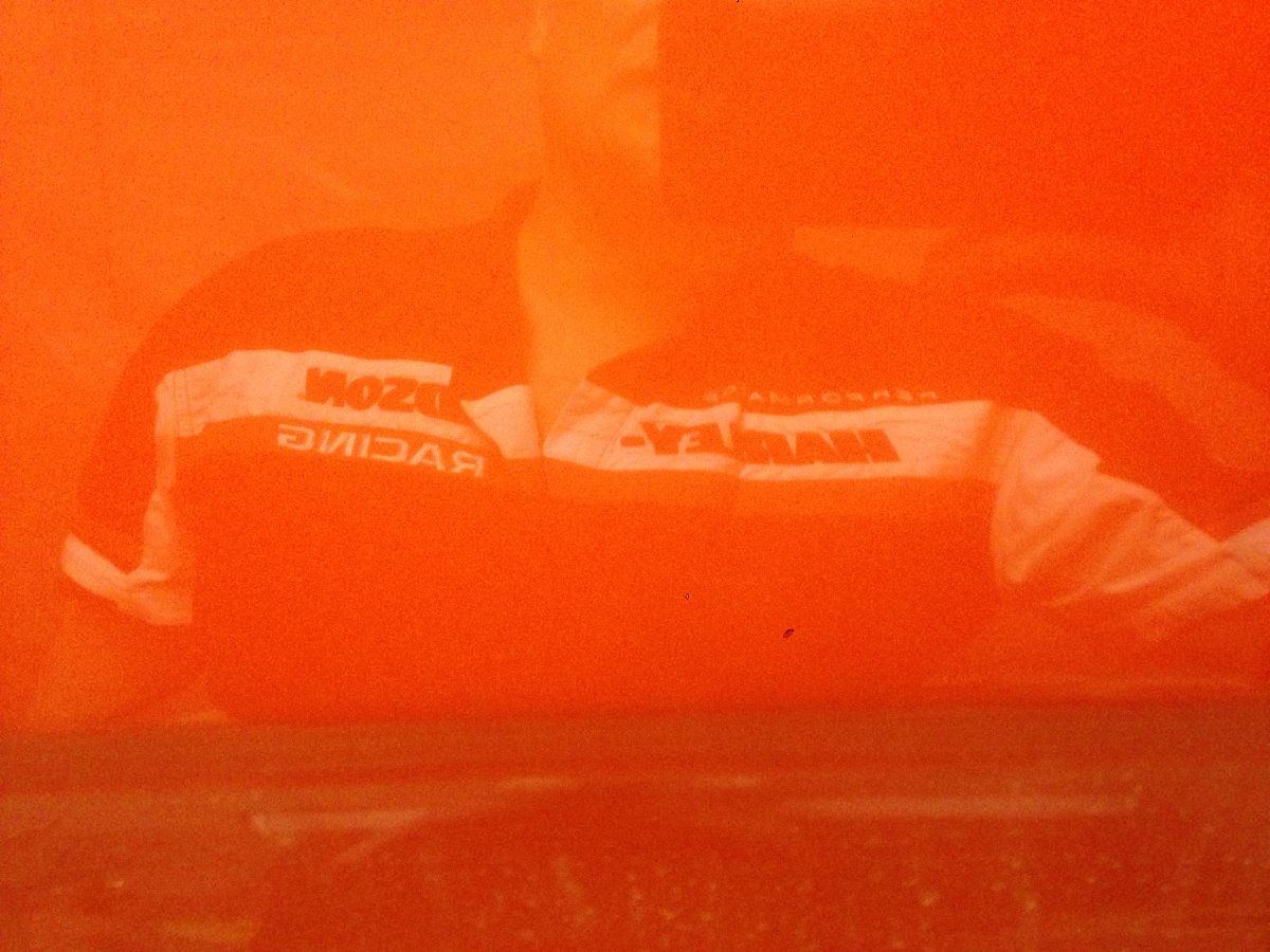

  3. The rotisserie shots are right off the gun.
    But after the flow coat done the second day.
    the close up has 2500 cut and 4 stages of buff on the flow coat.

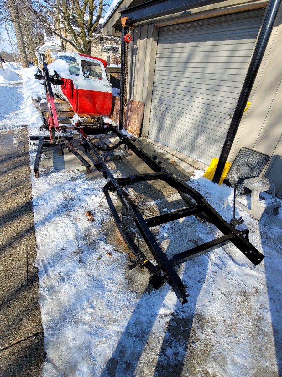

    This is Delfleet High Solids primer shot over blasted 60 year old frame parts. No sanding or filler. Shooting single stage this weekend. Will post some pictures next week.

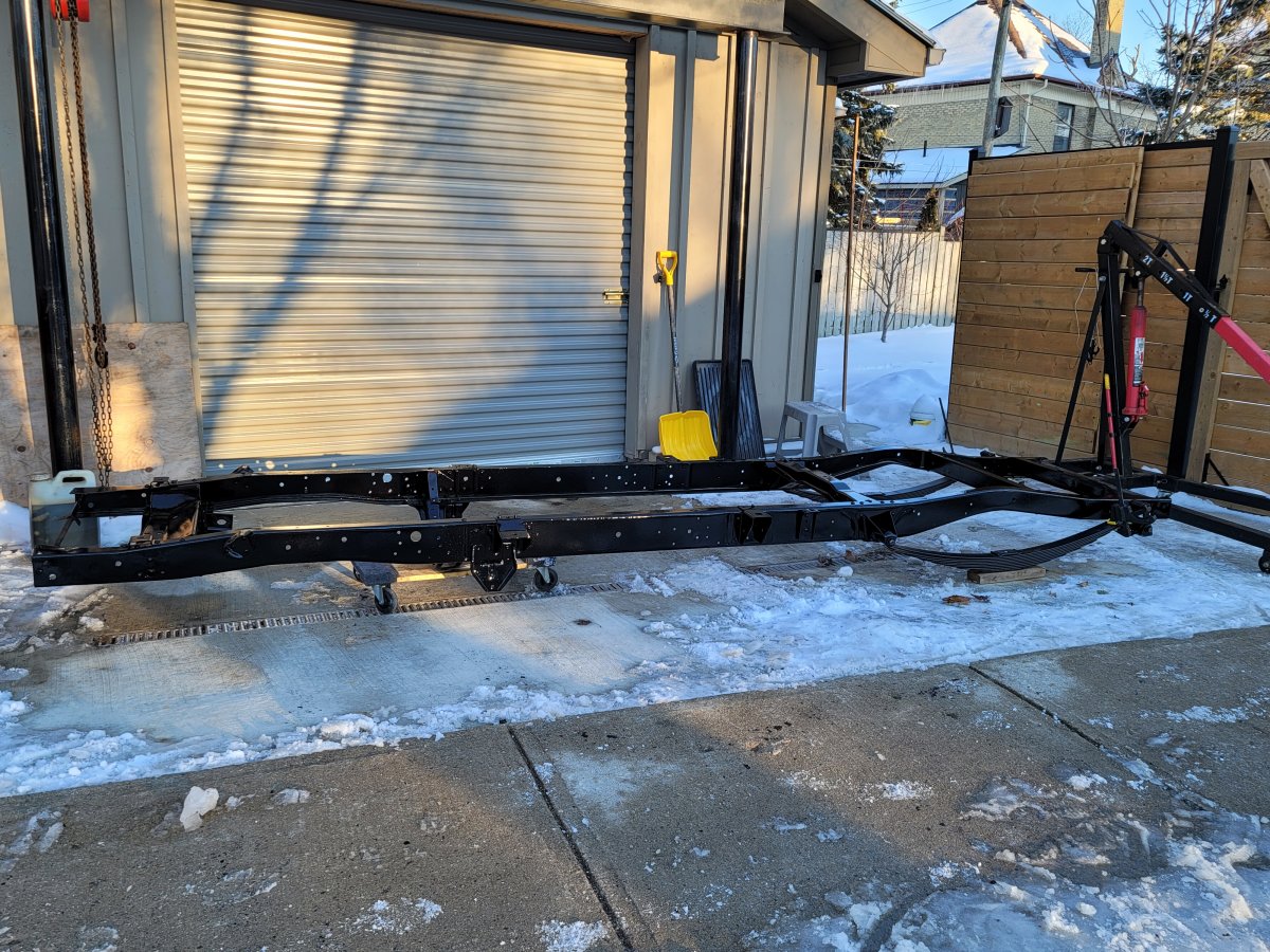

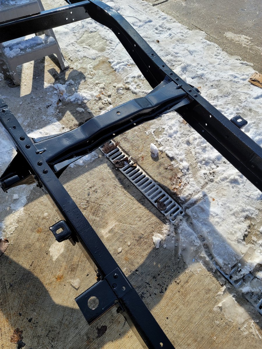

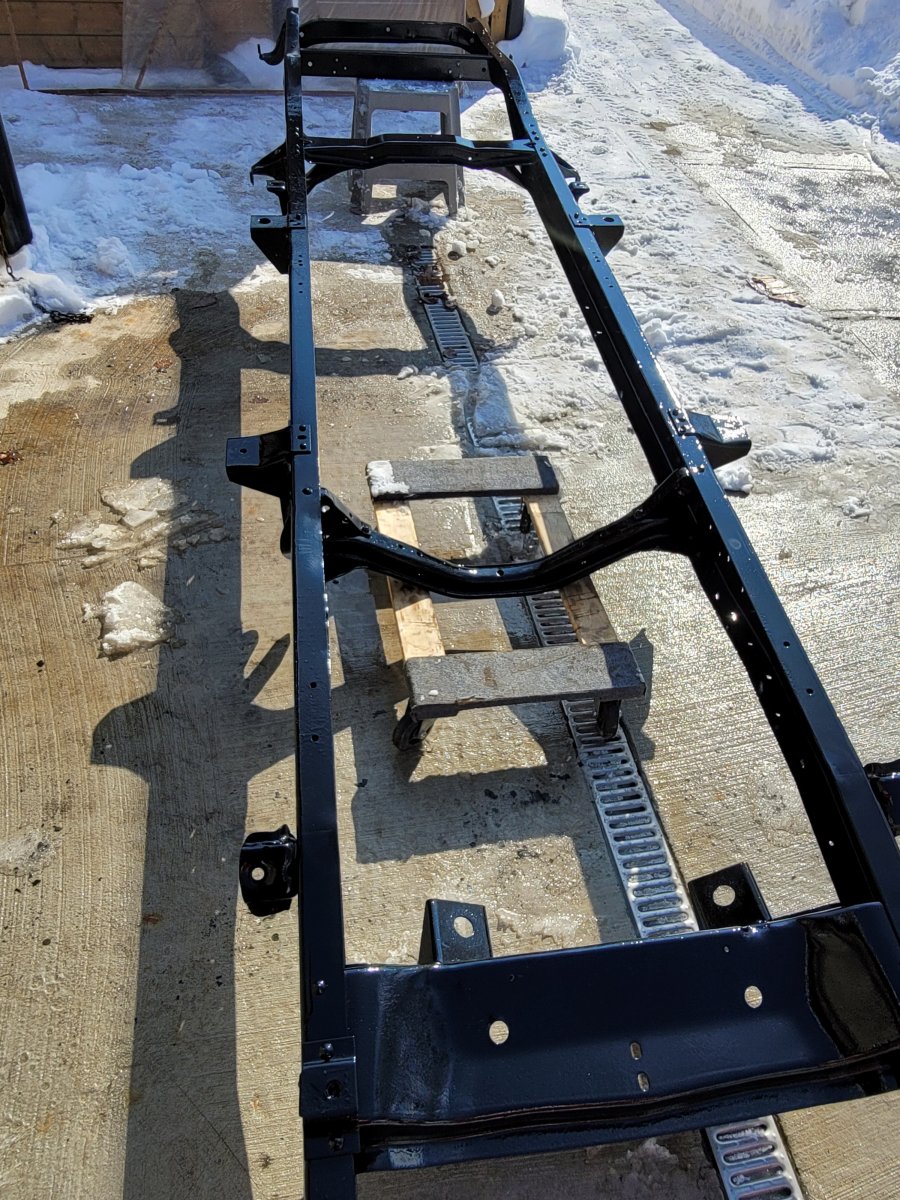

    Here's how my black came out. Have a few runs, but that's definitely user error (First time shooting Primer and Single Stage). Overall, it's pretty damn forgiving and laid down nice. I didn't high build or block sand the frame, so the pits show, but it's going under a truck so I wasn't too worried.
